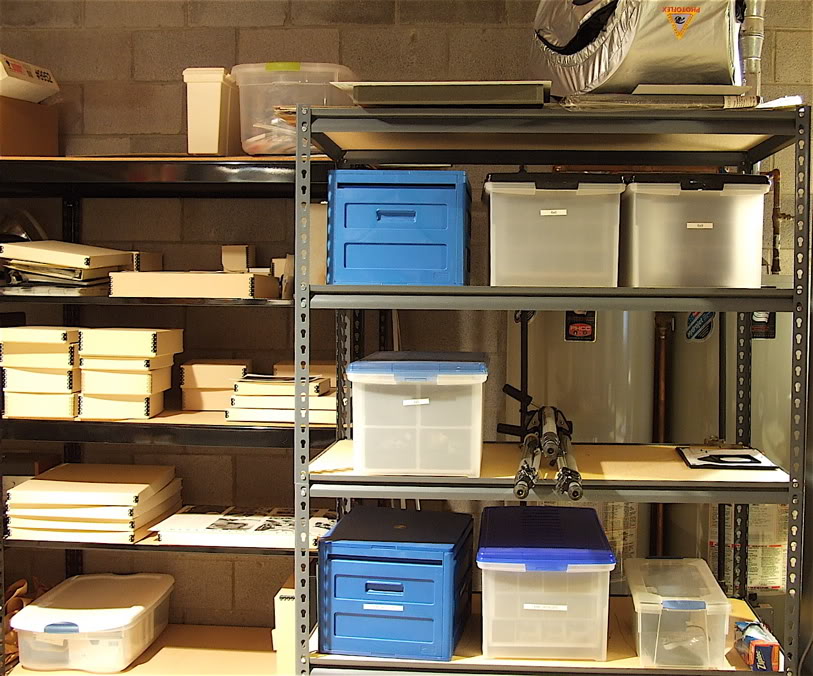

I use hanging sheets in these bins. That picture was a few years ago, I have 13 bins now.

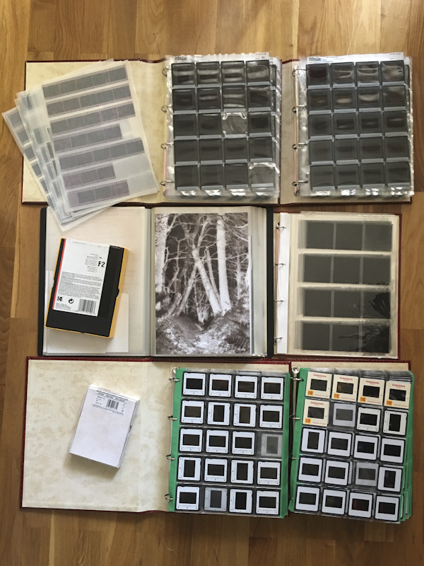

(Bottom . 3rd Row . Right to left)
Color slides in Album(s) | B&W slides in Album(s) | 9x12 on separate sheets in Box(es)
(Middle . 2nd Row . Right to left)
Color & BW (+ & -) 120 Album(s) | Album(s) for all prints up to 25x30 | 13x18 on separate sheets in Box(es)
(Top . 1st Row . Right to left)
B&W Negatives | Color negatives | 135 Film bags awaiting single free frames ...
