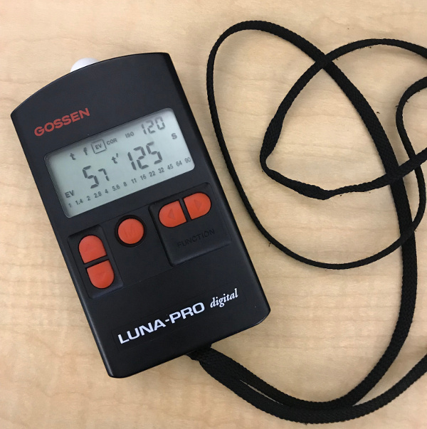

I thought I'd update this thread as I've just acquired a Gossen Sixtomat Digital light meter. It's in good condition and seems to work well. Importantly for me, it's easy to use and to read (without reading glasses).
Unfortunately I didn't get good results with the light meter app on my iPhone so decided to buy this light meter.

Excellent choice! I have one of these and really like it. Be careful with it though, given its small size it is tempting to carry it in a pants pocket. Mine was fine in the front pocket of my jeans for years and then, one day, it was hot, I spilled a little water down the front of me and some apparently got into the meter....and...it didn't survive....not sure what happened but the display was whacky for a long time...eventually, it healed itself, but I was bummed and without my meter for many months.

Thanks for the advice, @BradS
It looks like the same meter has a different name for the US market and the the European market. I had a quick play around with it this evening and it seems fine. I'm gearing up to use it with one of my manual film cameras.

The original names of Gossen meters already can be confusing. The renaming by the US-importer made even a mess... from todays perspective. Back then there was no internet, often even no books and magazines from abroad.
