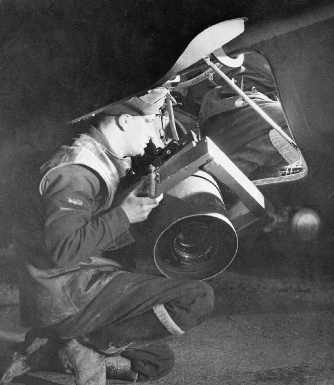

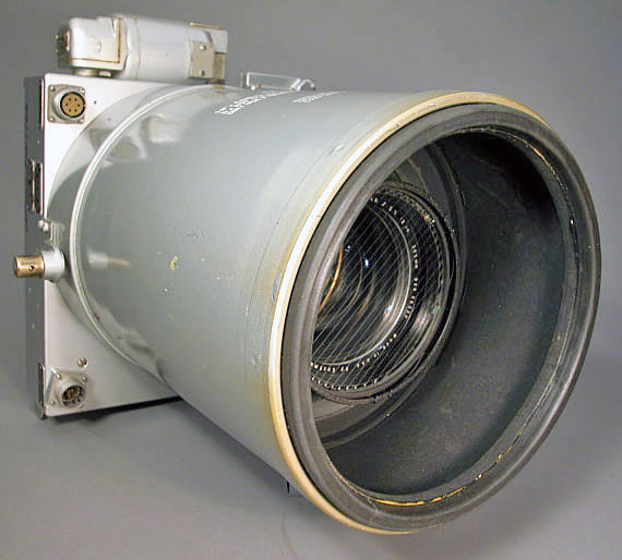

Also, physixvox (see above) is correct in the original usage of this lens. My edition was manufactured in 1953, so was a late version and incorporated anti-reflection coatings. Not as good as they are today, but better than its predecessors which had nothing. This lens flew in a Fairchild K-37 aerial reconnaissance camera. They dropped flares at night which emitted strongly in the IR spectrum. This allowed them to use 9" x 9" IR B&W film to make their images. Strangely enough, all documentation says they only used a yellow (minus blue) filter for this combination instead of a true IR filter. I am very eager to test this with my IR film, using a yellow minus blue filter, a #29 deep red filter and finally a true IR #87C filter. I have all these in 6" x 6" gelatin filters to cover the lens opening. This should certainly answer many of the questions regarding resolution and aberrations.
I have attached a few more images to share- the original Fairchild K-37 camera my lens came from, the camera being attached to the reconnaissance plane, and finally a 4x5 image of the Old Mission here in Santa Barbara that I took years ago while a student at Brooks Institute. It was a 1 hour exposure and was illuminated by star light and a streetlight 2 blocks away.
