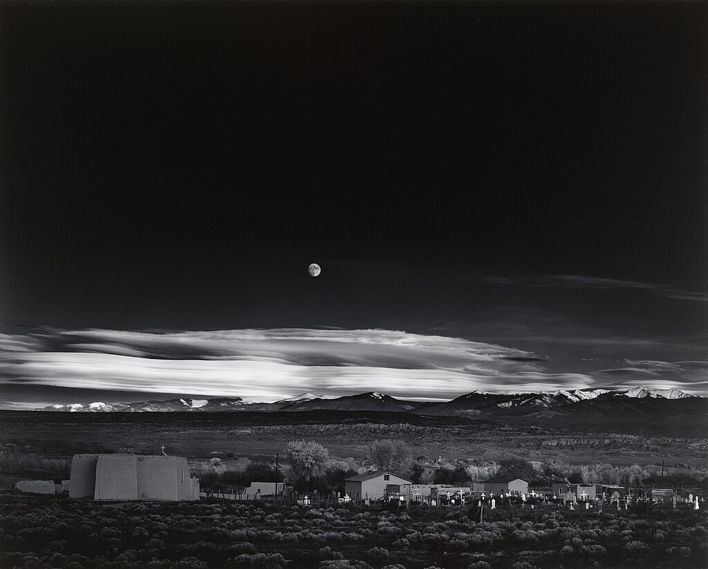

I saw a dup neg of Moonrise, Hernandez at Jim Alinder’s studio in Gualala. It’s very thin and a straight print from it would be ugly
Does that mean the dup neg was exposed badly and thin? Or was the original badly exposed and required much manipulation to produce a good print?
The highlights on the original Moonrise negative are very well exposed.
The majority of the rest of the foreground of the image fell into reasonably detailed shadows or near shadows that exhibited lower than ideal contrast.
I think we can agree that those foreground details are critical to the image:
By Ansel Adams - https://www.moma.org/collection/works/53904, PD-US, https://en.wikipedia.org/w/index.php?curid=33596857
Many, many great prints by many of the best photographers have required lots of work. There’s nothing wrong with that. Even so called technically perfect/ideal negatives can require a lot of effort to print to the photographer’s satisfaction.
Apparently there are some people that have a hard time understanding this. Completely baffles me.
AA said himself -- the light was disappearing FAST. He had only seconds to set up, and had to "guess" the exposure. I would have done the same, and ended up with a less-than-perfect negative as well -- as AA described it.
BUT, if it were me, I would have added at least another foot to the black sky -- but that's yet ANOTHER improvement I could add to the PERFORMANCE IN THE DARKROOM!!!!
