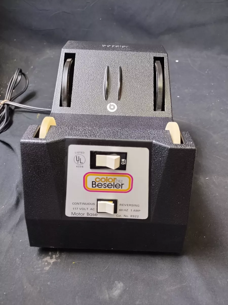

Look for one of the rotary agitators - Beseler, Unicolor, Cibachrome et al.
Like one of those seen below depicted with a film developing apparatus.

The agitator:

Matt's contraption probably works fine -- a Mattraption -- but it sure looks time consuming. Processing rolls of film in tubes wastes a lot of chemicals -- if used once. Processing sheets (of film or paper) in tubes DOES NOT. Apples and oranges.
The contraption pictured was simply my effort to see if I could use rotary processing for film with tanks that take steel reels.
And it works well, although if you use it with steel tanks, it makes a lot of noise. The outer plastic container is only there because the steel reel tanks I have are both two short to otherwise work with that agitator, and prone to leaking a bit when agitated that way.
I mostly use that agitator with either:
1) rotary tubes for print processing - as per the subject of this thread and discussed above; or
2) more frequently, for film, Paterson Super System IV tanks that take 2 x 120 reels or 3 x 135 reels, replenished developer, one-shot (normally) stop bath, and rapid fixer that is reused until it reaches capacity - thus very little chemical waste.
I used that photo to illustrate, because it was the only one I had that showed the agitator. For the purposes of this thread, you can ignore all the rest.
Here is another photo of a similar agitator borrowed from eBay:
