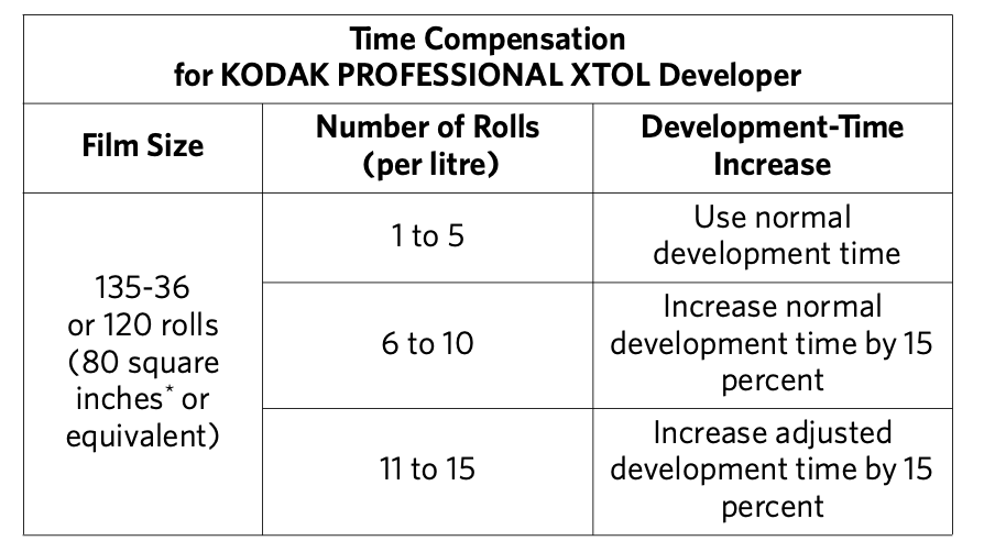

Is there a time adjustment formula from starting with stock solution and stock time to fully seasoned and 1:1 times?
Yes. It is in the datasheet. Look at this table:
Each roll developed in the same 1L increases the development time by 3%. Once you approach 1+1 times, you can consider your batch to be seasoned. BTW I find it interesting that the definition of "seasoned" for Xtol is missing. Kodak does not sell starters anymore, and people season by developing films each arriving at their own unique stable activity level. It's not even remotely close in precision to seasoning and replenishing C-41. If you search archives, you'll find a thread where folks posted their Xtol-R times. They were all over the map, like 2x different for some films!
I am now a bit confused. Isn't the above table meant for a non replenishment system whereby you use a whole litre of the same unreplenished Xtol by pouring the 250ml of developer for one film back into the one litre and continue to do this for each film with the increase in times stated until you get to 15 films when you dump the whole litre and start on the next fresh litre?

@pentaxuser yes, that's what that table is for. But it just happens to be exactly the same activity as seasoning Xtol by developing films in it.
Thanks
pentaxuser
What Steven said. The idea is that you stop doing that - before 15 rolls have gone through it - and switch over then to replenishment. That switch happens when the developer is only partially/slightly used up/imbued with development byproducts, and from then on you use and replenish it.
This maintains the working solution in an intermediate, steady state that provides high quality, predictable results at a very low cost - often one package of X-Tol will be enough replenisher to develop ~70 rolls of film.
