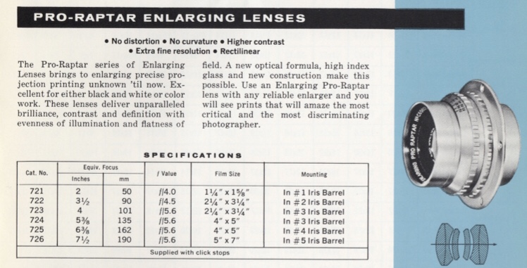

Wollensak’s Enlarging Raptar f4.5 lenses are the four-element Tessar design, but the Enlarging Pro Raptar lenses are six-element Plasmats and can usually be found at a reasonable price.
