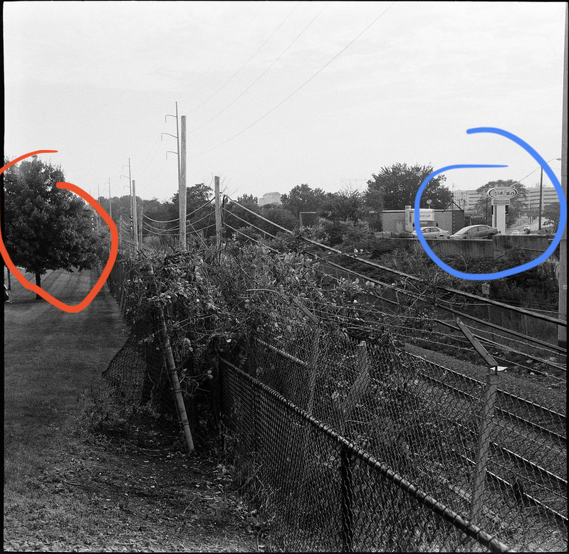

Hmm...somewhat. I'm fairly sure that the ailment exists, but I'm not sure how consistently serious it is. If you take a look at some of these test-ish shots, it ranges from fairly extreme: https://www.flickr.com/photos/12802682@N00/51329272576/sizes/o/ , https://www.flickr.com/photos/12802682@N00/51538676667/sizes/o/
To "not too bad" : https://www.flickr.com/photos/12802682@N00/51540388420/sizes/o/ , https://www.flickr.com/photos/12802682@N00/51540399080/sizes/o/
To "there, but not particularly noticeable" : https://www.flickr.com/photos/12802682@N00/51539472241/sizes/o/ , https://www.flickr.com/photos/12802682@N00/51538696217/sizes/o/

Frankly I don’t see what you are talking about.
The railroad fence photo with the wire fence dead on is an ok test.
The wire appears to be an equal amount out of focus.
The same with the detail seen through the fence. It’s equally in focus all over the image plane.
All the other photos have too much going on topographically to say anything for certain. But I don’t see any problems with them either.

I think they're all a bit topographically hard to figure out! The railroad fence is definitely the obvious candidate, though.

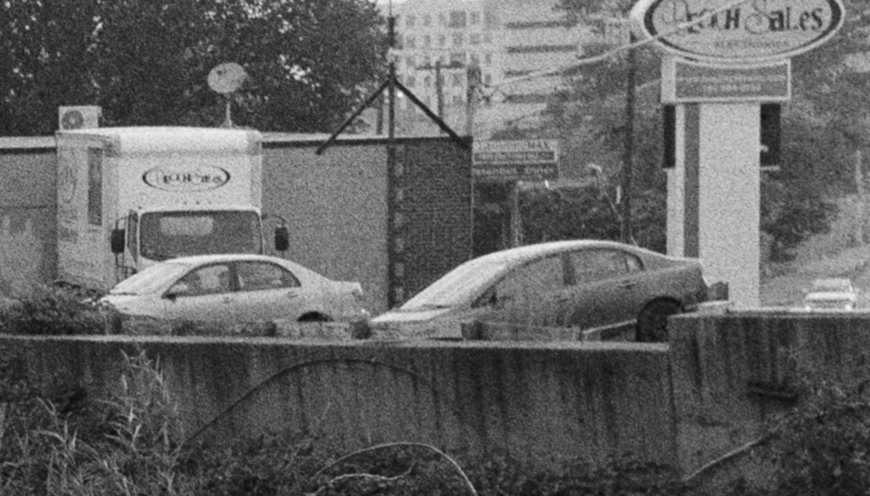

Focus was on the bush in the center of the shot. Either f/5.6 or f/8, I don't remember. The tree on the left is quite a bit closer than the cars on the right, but the cars on the right are in nearly perfect focus and the tree is way out.

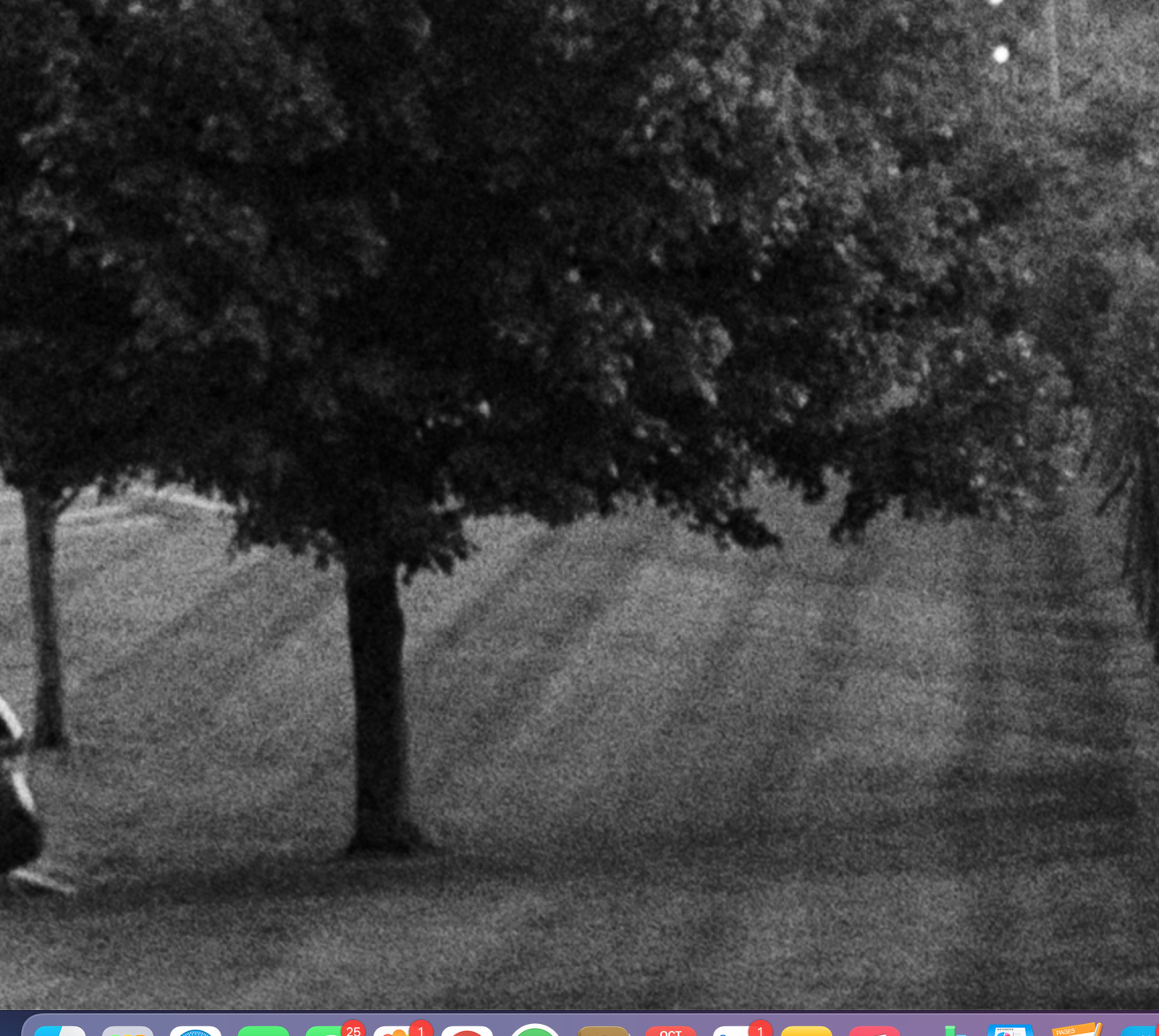

And the light leaks are actually reflections! The inner frame of the film gate is painted a not-matte-enough black, which I'm attempting to remedy.
The left example is from the extreme edge of the film plane and the other a bit further in. Grass and leaves are also a bit more ambiguous too WRT contrast. Both due to the diffuse lighting and the colours that are quite close.
I was referring however to this photo:
https://www.flickr.com/photos/12802682@N00/51540388420/sizes/k/
The light leaks looks very much like a film edge leak. Not like something that happened in camera.
The edge of the film gate would not really have a chance of creating that kind of pattern.
The anti halation dye of the film would take care of that kind of reflection from anything parallel to the film plane.
And a shiny surface parallel to the projected light would not create that kind of wavy, peaky pattern.
Light leak is what I thought in the beginning, too, but I 'tested' that on a few frames by covering the lens and leaving the shutter open while I shined a flashlight everywhere I figured a leak could be. Nothing! However, when I put Shurtape around the edges of the gate, those bright spots disappeared. I even left one border untaped as a control, and that side still had issues. The 'phenomenon' is most pronounced and readable in this shot, where all of the leakish looking flares at the top of the frame correspond with highlights right up against the gate. I swear I'm not crazy!
