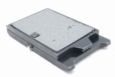

When you say its missing a "focusing back" I assume you mean it has no ground glass for focusing, so you're looking for something like this:
What might also work for you is a ground glass that can mount, not with the spring loaded arms that allow use of double sheet film holder, but a piece of glass that can mount using the international/graflok mount that I assume you still have. I needed glass like that for nother camera, and I salvaged that graflok glass from a Horseman rotary back:
The plastic framed ground glass sometimes comes with an angle viewer(which can come in handy though bulky)
