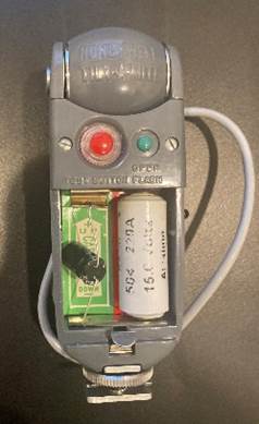

The flash holder
I ended up with three: the Honeywell TILT-A-MITE, The Kodak flash holder, and the Kodak BC flashholder. Each had advantages.
The TILT-A-MITE
This is relatively small, has a tilting flash head, and accepts AG-1 miniature, M3, M5, and P25 bulbs. It requires a 22.5 V A221 505A Alkaline battery available from Amazon or B&H. I read where a 123 battery will work, but I could not make this happen. It also has a small old style paper capacitor which may not work. I tell how to fix this later. The 3 inch reflector expands to the open position, has a satin finish, and the flash will attach to a hot shoe (non-powered) or tripod.

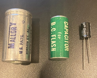

The capacitor
The old-style capacitors were made of rolled paper and an electrolyte solution. As they dried out or the chemistry changed with age, they ceased to work. The good news is that you can replace them with a modern capacitor. You will need a 220uF 35V 220MFD 35 Volt capacitor, and I bought 10 for $5.99 on Amazon. You will have to remove the old capacitor from the Flasholder. This pops out in the Honeywell, and required removing one screw holding a contact in the Kodak. Be sure you put the screw and contact back though. Then solder the new capacitor in place, taking care you put the positive (+) end of the contact wire on the positive terminal of the capacitor holder and the negative on the negative end. I didn’t have a soldering iron anymore, but I found this really great small one with all the accessories I could possibly need for & 14.39 on Amazon. That’s it, and now all my flasholders work great. I’ve included some pictures of my soldering work and the old and new capacitors:
The TILT-A-MITE

The capacitor
View attachment 398251 View attachment 398252 View attachment 398253 View attachment 398254

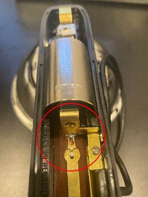

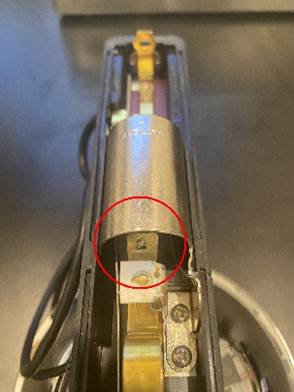

I have to make a correction here. The 22.5 V battery for the BC flasholder burned out the ceramic capacitor I installed. I guess the battery had too many Amps or something. I'll replace the capacitor and just use a C battery, which I know will work. Sorry for the misinformation. As I mentioned this is trial and error for me.
James
The capacitor has a Voltage rating which should not be exceeded by the supply. A Tilta-a-Mite BC flash in the past was 15V battery (Eveready type #504)
If you fried the capacitor, select one that matches/exceeds the 22.5V rating of your substitute battery. Someone once posted that the stored charge in the original capacitor is 400 uf.
JKW284
JKW284
May 5, 2010
8
Thanks for the tip. Maybe that was the problem. The capacitor I used had 200mF capacity. I used another capacitor rated at 200 mF and changed the battery to a C battery and so far it works. If it fails, I'll try the 400 uF capacitor. Still learning as you can see.
The capacity of the cap was not the issue...that is merely the amount of charge that it can store, to later discharge throught the flashbulb. It is the max Voltage rating of the cap that was exceeeded via the 22.5V of the battery that supplied the charge which exceeded the amount of electrical force that the 'container' could withstand.
