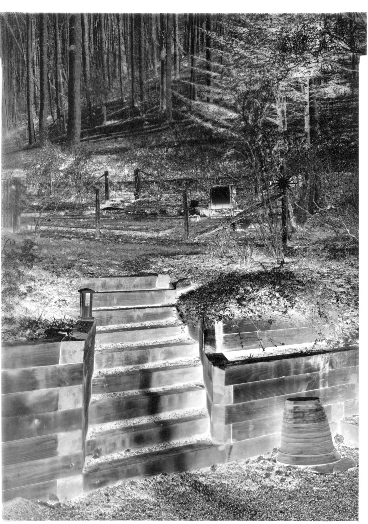

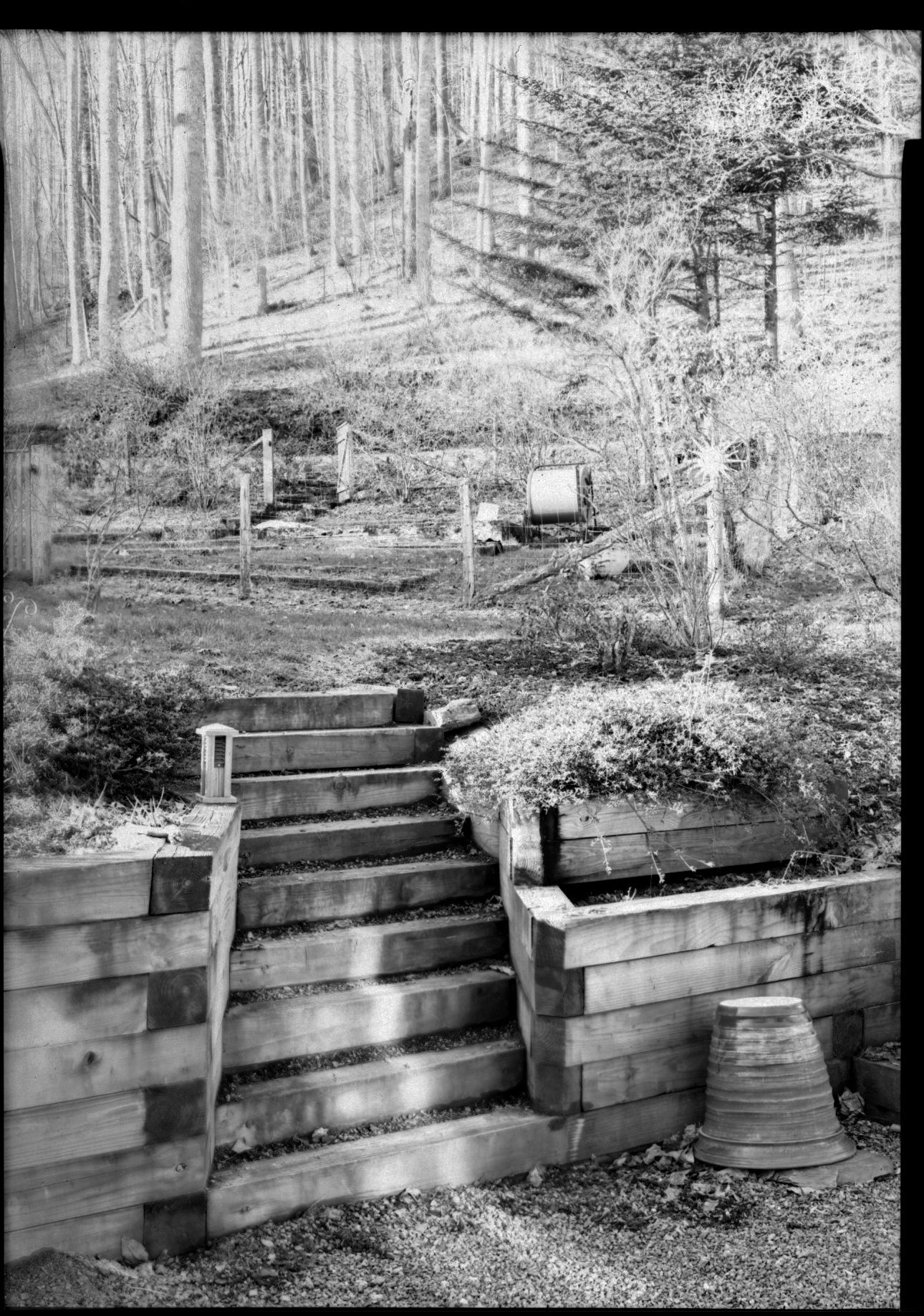

DS-12 negative and positive scan
The files attached are the result from DS-12 stock w/FP4+; souped yesterday.+
It is difficult to get good results from my inexpensive (old) flat bed scanner.
