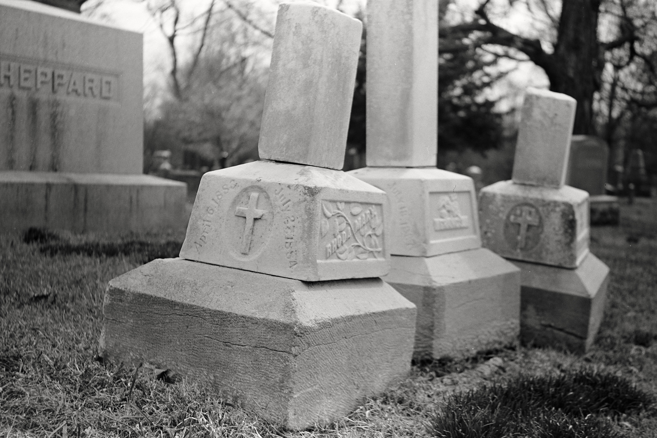

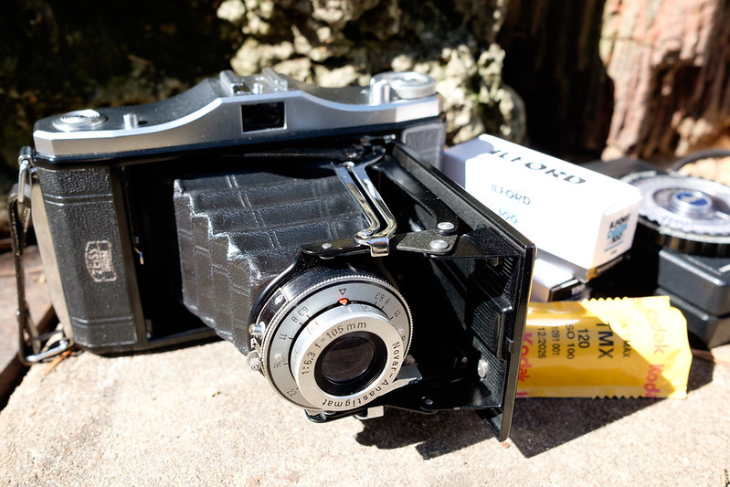

First roll through my Zeiss Icon Nettar 517/2. Mine has the 105/6.3 Novar-Anastigmat, which I believe is a triplet design(?) First photo at f9.5 and minimum focusing distance, which is a little less than 7ft. Second photo at f8.0.
Mine has a Vario shutter with speeds of 1/25th, 1/75th, and 1/200th second, plus B. When shooting this test roll, I was hoping to use the widest aperture (f6.3), but with Kodak Tri-X metered at EI 250, even on this cloudy day, and using the top shutter speed of 1/200 I still had to stop down some. Next time, I will try a slower film. And now I have a push-on filter holder for my Series V filters, so I can use yellow-orange-red filters and larger apertures due to the filter factors. This lens takes a 31.8mm or 32mm push on filter.
Still not sure how I am going to get on with scale focusing. And I think I am going to regret not being able to focus closer than 6-7 ft. Other than that, it is a jewel of a camera, and folded, very easy to carry. I believe the viewfinder is going to be much more useful than the one on the Agfa Clack, although I still have not tested just how accurately the Zeiss Nettar is showing the edges of the frame.
IMO not as bad as I initially thought. Get your eye close to the v/f lens, but do not try to "peek into corners". If you want to gain some assurance, tape some tracing paper over the film gate, dark cloth, determine actual FOV; compare with what the v/f is showing.
