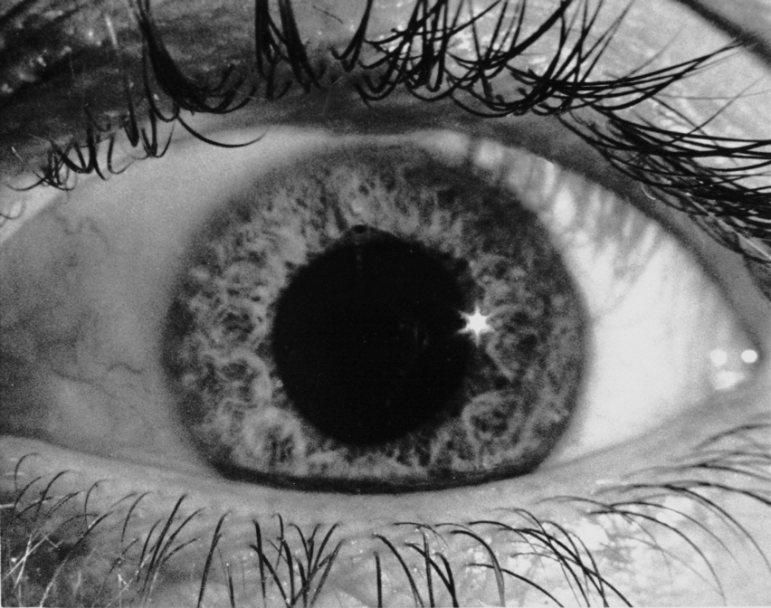

Perception vs Fact
I photographed a pair of eyes in 1964 and enlarged the image to 30in X24in. I used a condenser enlarger and an Ektar enlarger lens. I'm submitting a copy of full size crop from that print. I have printed the image many times with a diffuse light source and while the resolution may be the same, no print from the diffuse light source gives the same impression of sharpness as the condenser light source enlargement. The image was taken in 35mm, Panotomic X with an Exacta VXIIA and 50mm Pancolor lens at f16. Development was in Microdol X 1+3. Sometimes, perception is greater than fact.
Denise Libby
