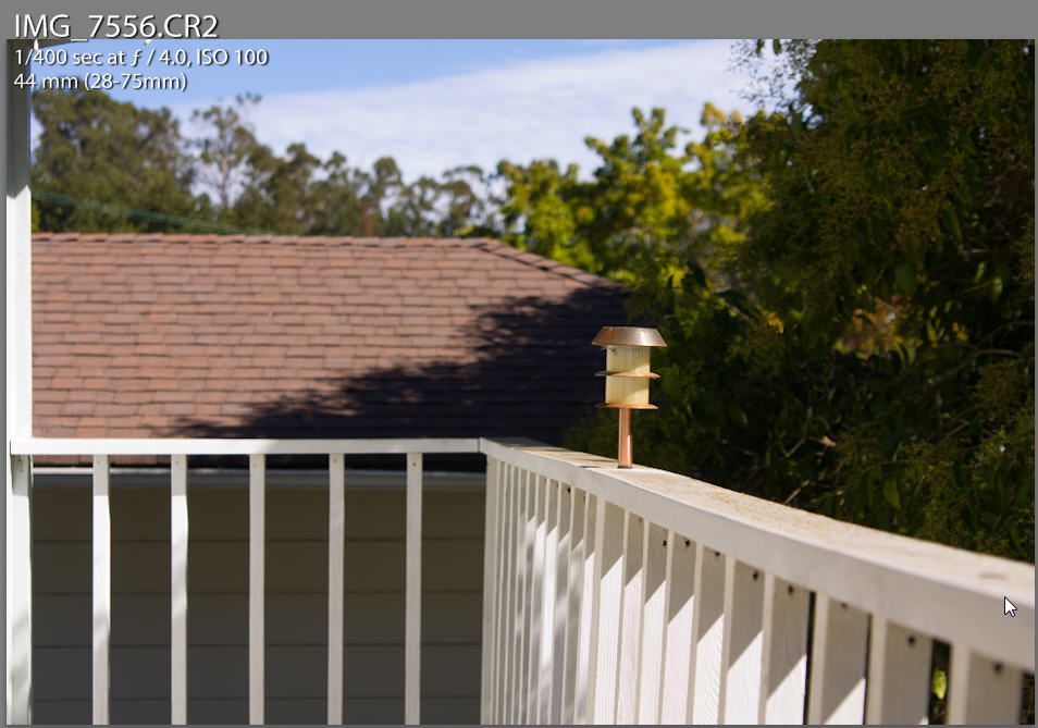

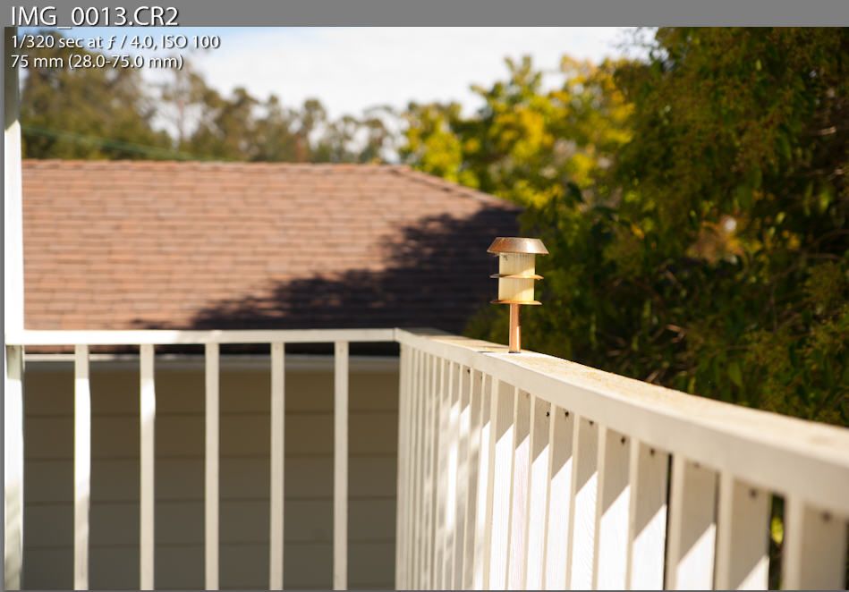

And to illustrate the effect of longer FL on background out-of-focus blur quantity, both nearfield b/g and far field b/g, here are two similarly framed shots, both at f/4 (the way most photographers think -- not 'aperture' size) with the 1' deep DOF vs. 2' deep DOF zone, and comparing how the near- and far-field background is blurred for each. Larger format, then smaller format...

A great illustration of how it's not just about the "zone of sharpness".
