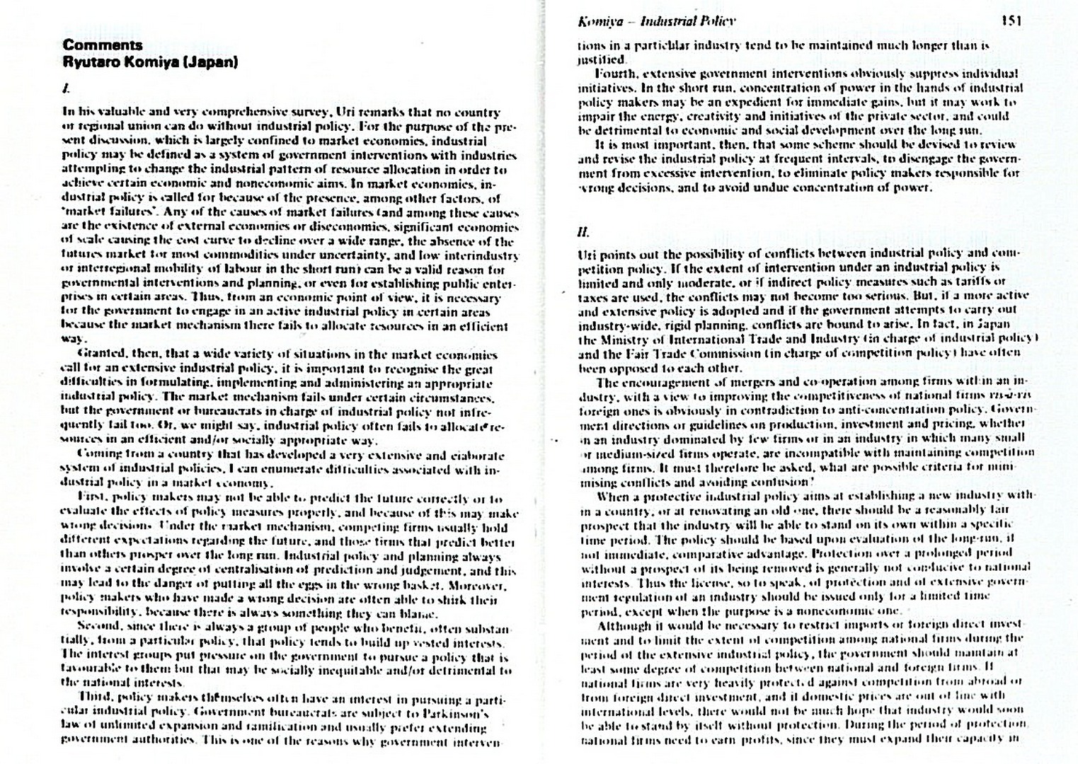

Thanks, I tried only Primefilm now with 3600 dpi and Vuescan software. Vuescan settings are: scan as positive, improve sharpness, strong infrared cleaning . The result is readable. Its screenshot is attached. The full file can be downloaded from here. But there are a lot of errors, when recognizing with Finereader. As for other scanning options, I search them now. I changed Vuescan settings, There were no essential imrovement.

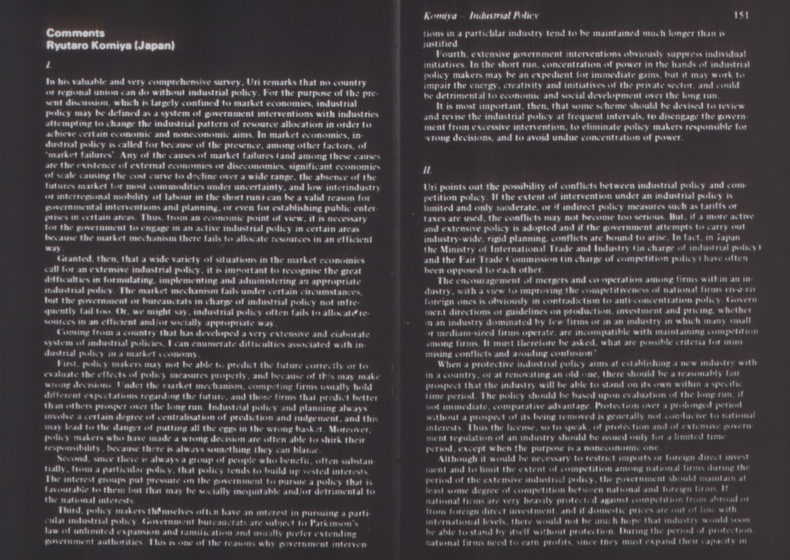

This edited version of your example might be marginally better for OCR:

Thanks for providing the example. I'm afraid that this scanner just doesn't cut it for this task and that you'll need a higher-resolution option.
One thing you might consider is photographing the microfilm with a digital camera and an appropriate macro lens and/or extension tubes. It looks like you'll need more than 1:1 magnification, which makes things a little tricky, but still possible.
I agree. I think the extreme contrast is creating a halo around the letters. A digital camera using a good backlight might get a cleaner result.
