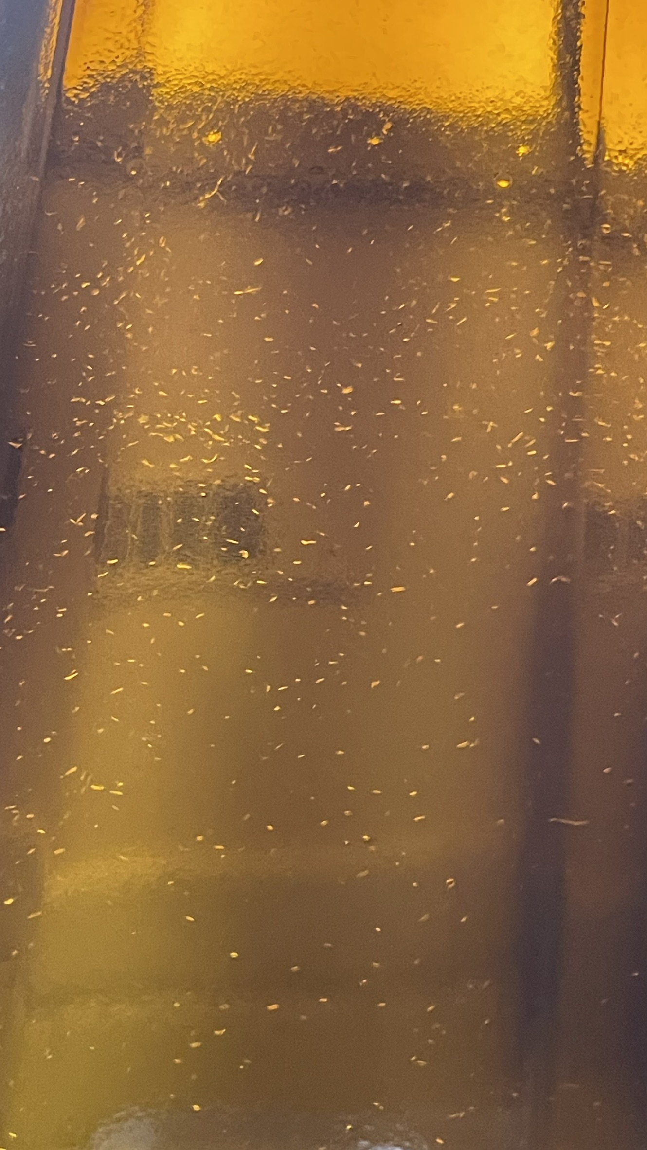

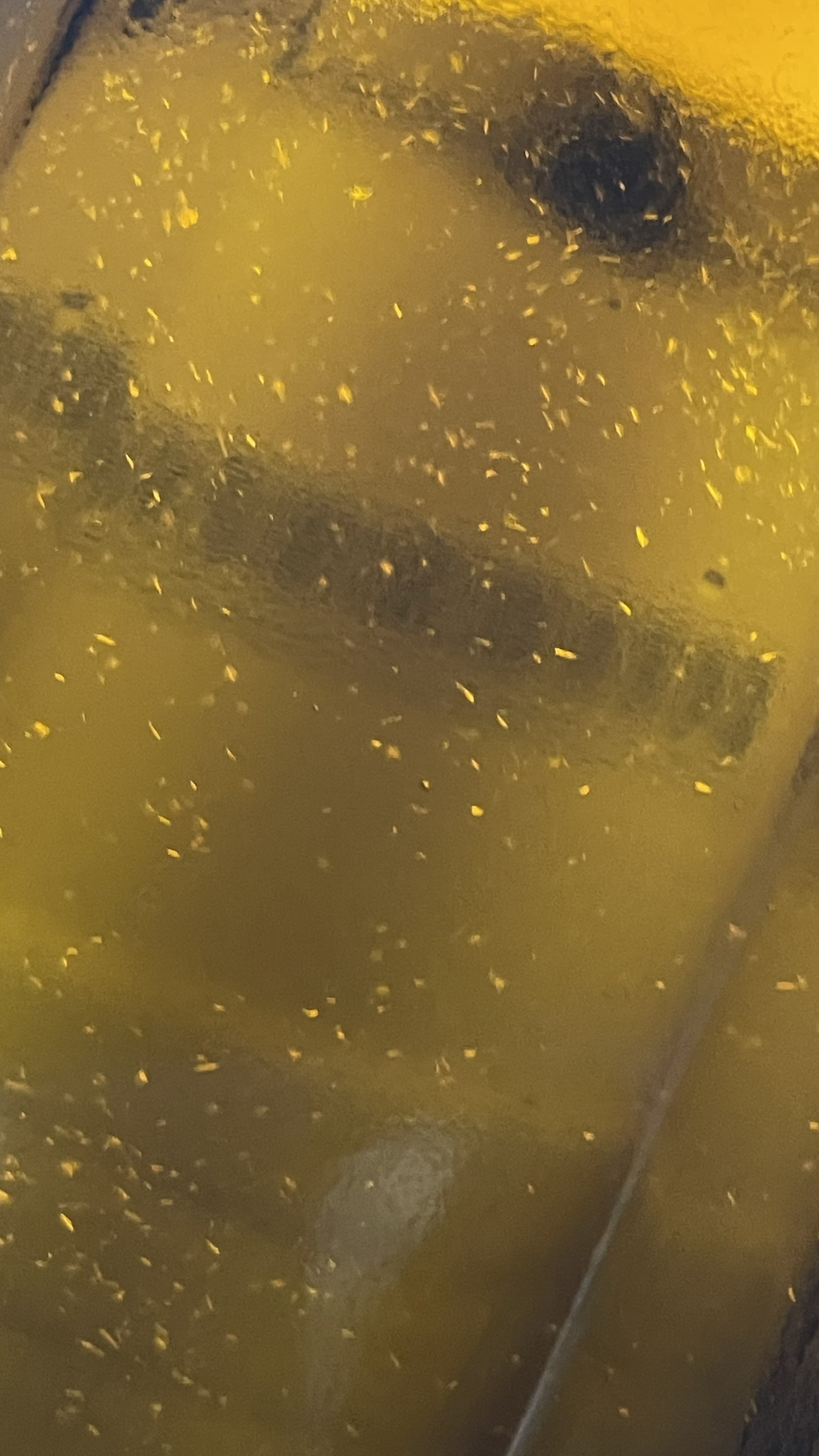

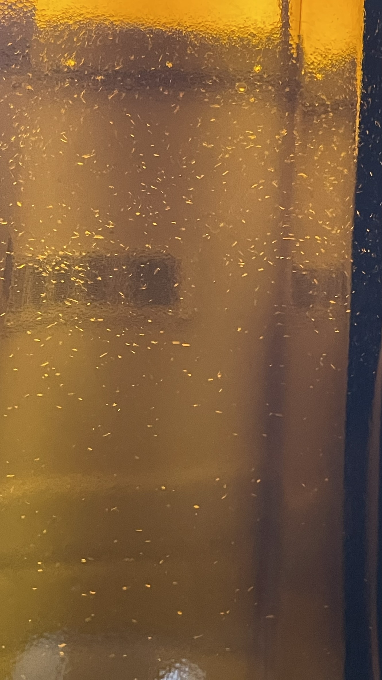

Hello
This is not the first time I see that, and I wonder what it is.
This XT-3 1 liter stock has 2 weeks, and is stored in 4 x 250 glass bottles, filled up the cap.
It’s just like small glitter dusts, sparks or crystal needles that dissolve slowly (for eyes, not sure at molecular level) when I agitate the solution.
It has been prepared with demineralized water.
I should better throw it away or I can use it?
Thank you for your guidance and understand what to expect :smile:

Looks like something has precipitated out of solution, these look like crystals.
Try heating the solution to 40C and see if the crystals go into solution without any shaking and now stay dissolved.
It is possible that one of the ingredients in the developer never completely dissolved and there are always microscopic crystals floating about that serve as growth sites. Possibly Part A wasn't completely dissolved when Part B was added?
By the way (forgot to ask) was it subjected to low(ish) temperature? Did you refrigerate this solution?
Thanks for replying, I will see how I can warm it a little bit.
Yes, all is possible, but I agitate with a magnetic agitator and don't hurry up doing it, much more longer agitated than the 2-3 minutes specified in doc.
More like 15 to 30 mn for each parts. Maybe it's too long finally?
Other information, the temperature is not high when mixing up (around 20+°C).
Then the bottles are stored in the dark at something between 19 to 23°C.
The first stock bottles I used didn't have this, it is only when it stays still some days not used.
I always check now for this "crystals suspension" because this is not the first time I had it.
And it is quite long to disappear at my eyes level, more then 4 to 5 hours with agitation every 30 mn at 20°C.

undissolved chemicals or ingredients are falling out of the solution while cooling. I anyway,harmless; just agitate or reheat slowly.
Too cool, never dissolved in the first place. Magnetic stirrers are great but with a large bulk amount like developer sometimes it's easier to use a hand held stirring paddle. Especially with the Adox Captura technology it dissolves so easily with warm water and gentle manual stirring.
Magnetic stirrers tend to throw the material out to the edges.
I will try later to warm a little bit more the water, even I never done it.
But why this appear later, when I don't have it say 24 hours after mixing?
Update: 6 hours after agitation, and in warm bath for 1 hour it is not dissolved, even if particles are smaller.

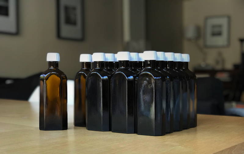

Just as another point of reference:
I use the 5l package, dissolve in demineralised water about 25deg C, stir with a large plastic spoon in a bucket for about 5min for the first part, the second part takes a bit longer, like 15min total (I let it sit in between if I get tired).
I store it in 500ml brown glass bottles around 17-28deg C and never saw sparkles so far.

If these are crystal like NEEDLES, then it could be what we call in Flemish 'Natrium Pennen' (I am not sure how it translates in English) and these can't be dissolved.
I think this is exactly what's going on here. I know exactly what you are referring to.
What causes these insoluble needles to exist and why might it only occur in what seems to be rare cases?
pentaxuser
pentaxuser
I'm not exactly sure why. I do know that in my experience it is failing to use warm, not hot, water and adequate stirring when dissolving the powder. I think it's re-crystalized sodium sulfite?? The Flemish phrase Google transaction is "sodium pencils".
I've got a lightning mixer, for powders,
"...The Flemish phrase Google transaction is "sodium pencils"..."
That's why I didn't quote the Google Translation...
"pennen" in this context is the description of longish shaped, hard like glass, crystals who don't dissolve anymore, not by heating nor crushing.
It happend on several occasion while I was mixing chemicals and I don't know by what it is caused, how preventing it and how to solve that problem.
