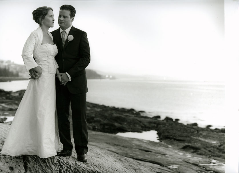

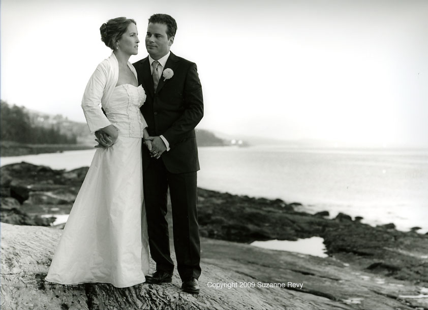

So, I spent some time yesterday in my darkroom, and had a brand new box of the Adox Variotone Warmtone paper in my paper drawer. So, I thought I would give it a go. I''m very pleased with the results, though I made the mistake of making a client print on it, and it's just different enough from some prints I made for them on Ilford Warmtone, that I may have to reprint for consistency.
I'm not the most scientific when it comes to testing things... but I thought I would share my results.
the first is on Ilford MG Warmtone in Ethol LPD 1:4, and I have not yet toned it. It's a nice crisp print, and the base is a slightly creamy white that many are familiar with. The Adox Variotone is very much a whiter base, and somewhat cooler midtones than the Ilford, but warmer, certainly then a neutral based paper. Also, developed in Ethol LPD 1:4, and not yet toned.
I intend to tone these in selenium for the client, and also in one or the Moersch polysulphide toners to see how I like it. When I tone them, I'll upload some scans.
Looking at scans is imperfect, but having them side by side, you can see a real difference between the papers. It's great to have these options. For a variety of reasons, I think this particular images will work better on the Ilford, but I can't wait to try some lower key images on the ADOX.
Oh, btw, the Adox print (on the right) is an 11x14 so it's cropped a bit on my scanner that's a little small for that size, but I included on both scans the paper base border.
Anyone else tried this paper, yet?

It's a bit lighter, and perhaps a hair less thick than the Ilford, I would say. At first, when I took the first sheet out of the box, it almost felt like an RC paper, but now that it's dried it looks very similar to the ilford in its surface quality, and it's a fiber paper to be sure. I'm not sure what you mean by "bendable", but it behaves in a similar way to the Ilford... I mean they have both curled similarly as I have air dried them. I'll press them after I tone.
I think the biggest difference, then, are... slightly lighter in weight, and the base is whiter, and the tones slightly cooler than the Ilford WT.
I think it's going to be a very nice paper to work with. It seems we have excellent choices, and can find a paper that will suite each image. I think, at the end of the day, high key pictures like those I've posted will work better on the Ilford with it's slightly creamier base... I like how it treats the highlights, but I think the Adox will be lovely for lower key images. Just my own personal preference, and it's great to have that choice.

Although the prints are still wet, so I can't scan just yet... I toned a few today in the Moersch Selenium toner, and the tone is lovely. It shifted the blacks ever slightly to a browner color with a 1:20 dilution at about 5 minutes.
I am LOVING this paper. When the prints are dry, I will scan and share here.

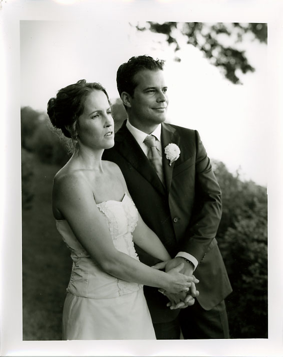

I made a few prints on Agfa MCC 111 (in Ansco 130) this week for the first time and really love the tone, the way they handled in bleaching and in selenium. Here's one of them...
I'm really looking forward to the Adox version...
At last... my example, toned in Moersch selenium, 1:20 for about five minutes. It's a little hard to discern the tones in the scan, but they have a lovely, slightly brown tone in the darks. I'm quite pleased with this paper and toner.
