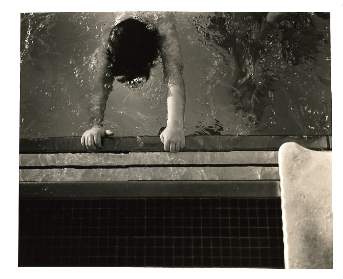

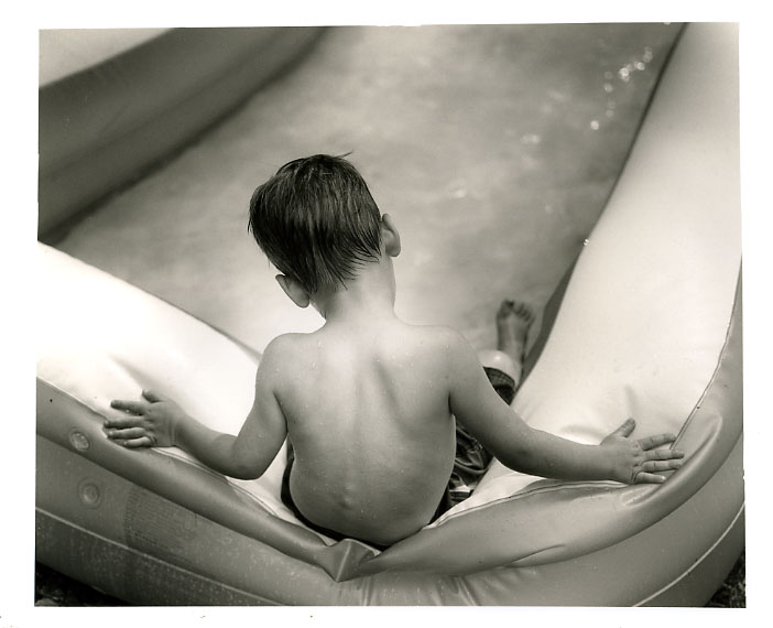

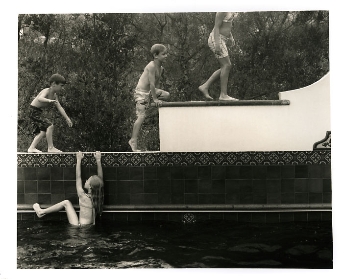

Just a bump, and update on some progress with this lovely paper... I did some toning yesterday in sepia, selenium and gold. I didn't care much for the gold, and it took me a few tries to get the bleach to a dilution that I felt I could control it. All a learning process. Anyway... here are my faves, each toned in sepia then selenium on Adox Variotone. (Fotospeed Sepia toner, Ilford Selenium toner)
Very nice Suzanne, when my three boxes of paper turn up, I think I'll try this combination, amongst others.
Mick.
Suznne, this is wonderful information. The Selenium toner gives a nice subtle warm tone. This is one I will have to try. I am always looking for something to fill the Agfa gap in my life.
Michel
Suzanne,
Obviously, scans can't replicate the experience of looking at the originals, but these images look incredibly lush. The look of this paper looks fabulous. Beautiful work!
Andrew

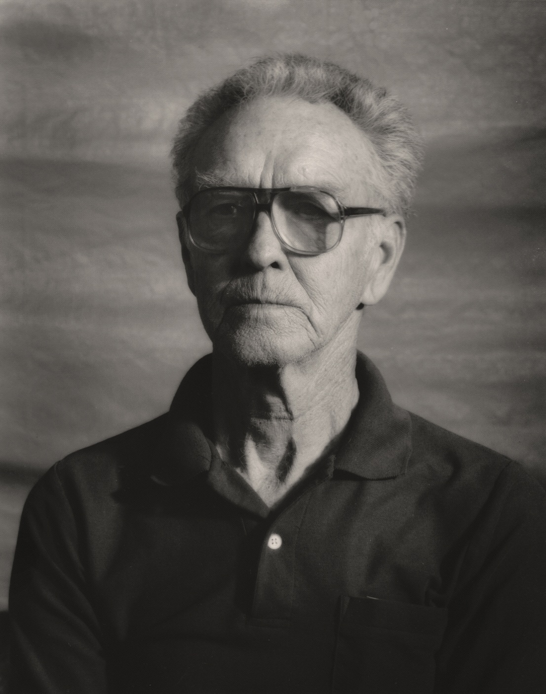

I just printed on Slavich Bromoportrait after using Variotone and MCC110 for the last few months, as I had a negative that really needed little contrast manipulation and OMG! what a beautiful paper. I mixed ID78 and some Ansco 130 to try the paper in those developers and right out of the ID78 it looks beautiful and in the 130 it is slightly cooler and the contrast increased about a 1/3rd grade. Still beautiful but when I toned the prints in 1+19 KRST for 5 min. the prints just came alive with the most gorgeous, deep, liquid, brown-black and highlights that just seem to glow. Of all the papers and toner, developer, combinations I've tried, this paper is something special. If you don't need MC and you can match your negatives to a graded paper, I believe that this is the one paper you should try if you want or need a warm tone that is rich without being too brown or red and just exudes warm and rich. Here is a rather poor scan of the film developer test print and as it turns out, paper discovery. I have no idea what the scanner will do to the tones in the print so the verbal description is probably much more accurate.
