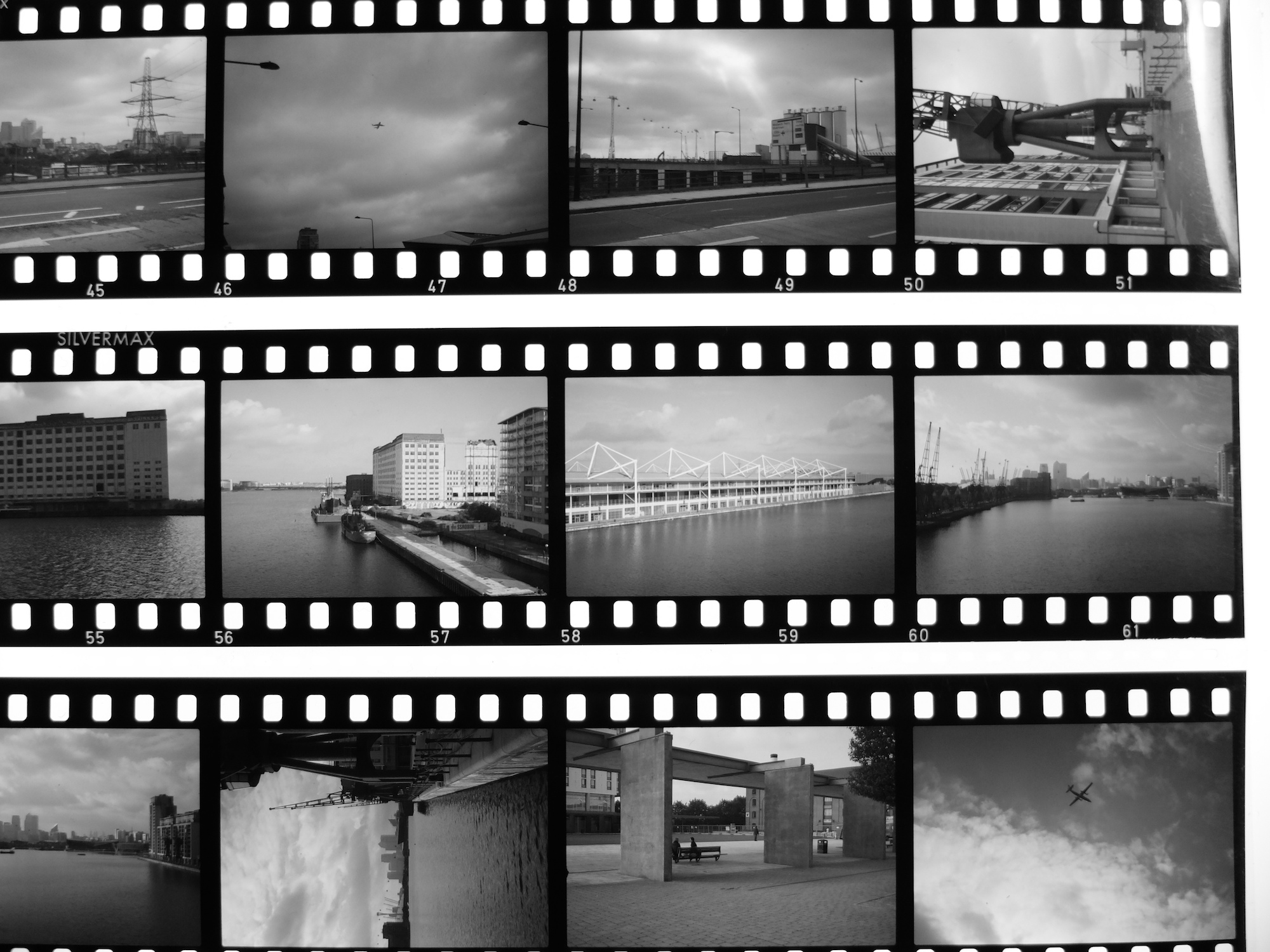

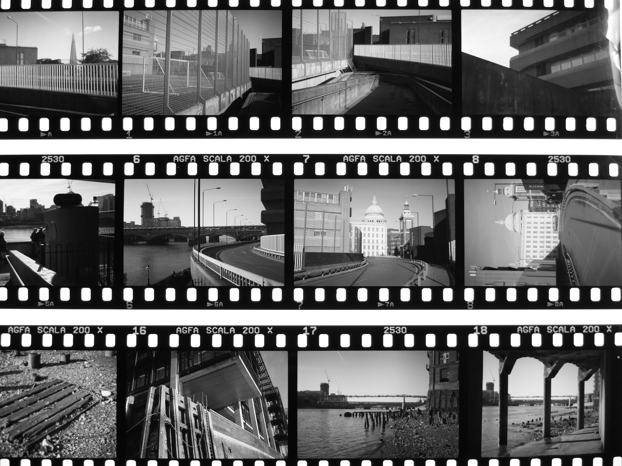

Here are some samples, a contact sheet of Adox Silvermax and of Scala both home processed.
Richard,
Did you chemically reverse the contact sheet or after scanning ?
Thanks
The examples are black-and-white transparencies I think, photographed in neg-sleeves against a light-table or equivalent. This is the sort of thing the re-labelling is intended to make easier, for marketing purposes and for adding some degree of certainty to the process required. Nice results :smile:
I processed the film as transparencies myself using my own brew after gleaning knowledge from many informed posters on threads here and other sites. I use a PQ developer and well documented bleach, clear, light reversal, 2nd develop process. It takes a lot of experimenting and the results can still be variable doing it yourself, but I get a a kind of satisfaction with that if it doesn't quite work.
The posted images are indeed images of transparency frames illuminated on a light table and shot with a digital camera. I thought that would be a better way of comparing, as was asked, as it incorporates more scenes and reduces, or at least standardises, potential variables.
