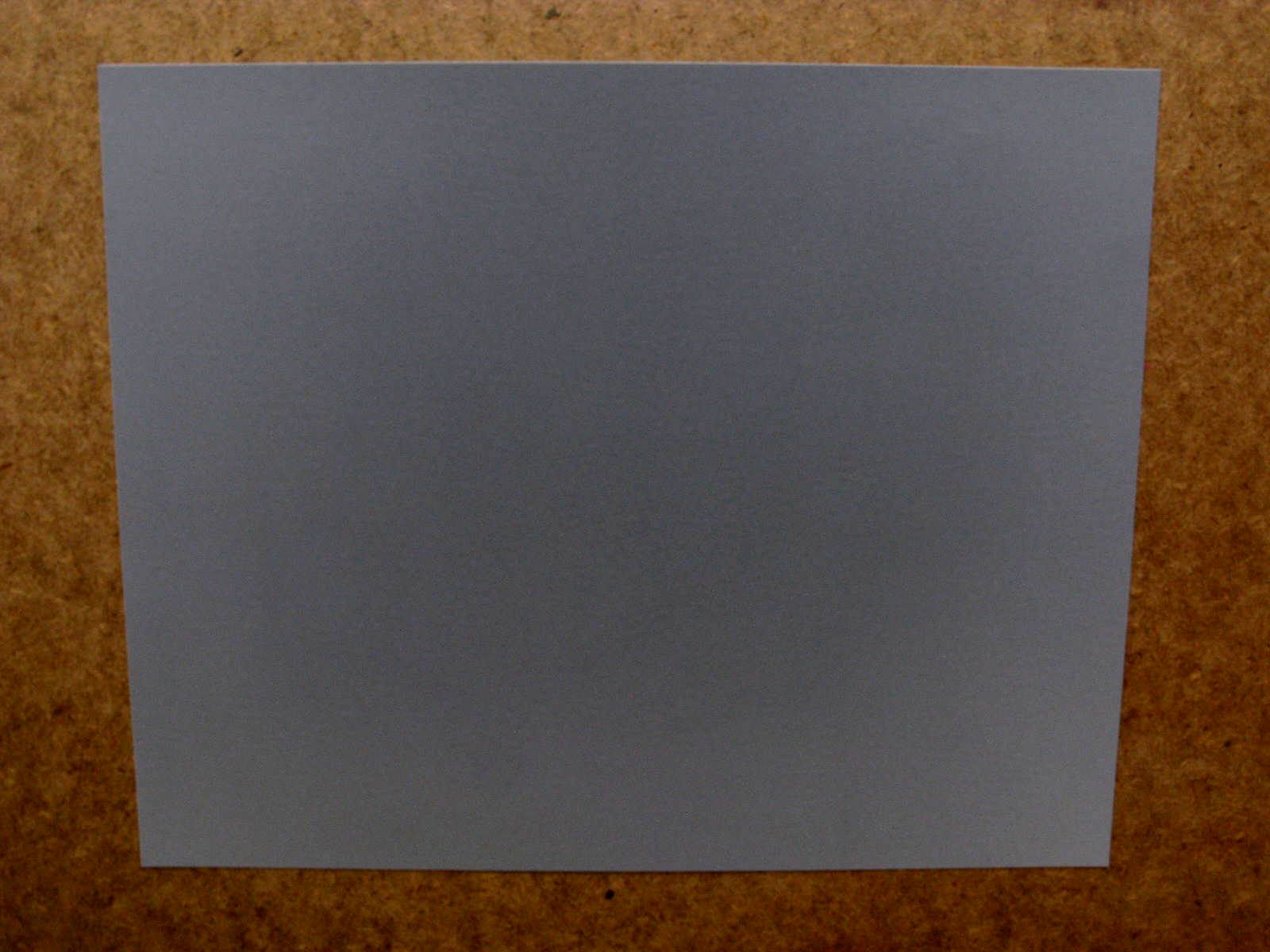

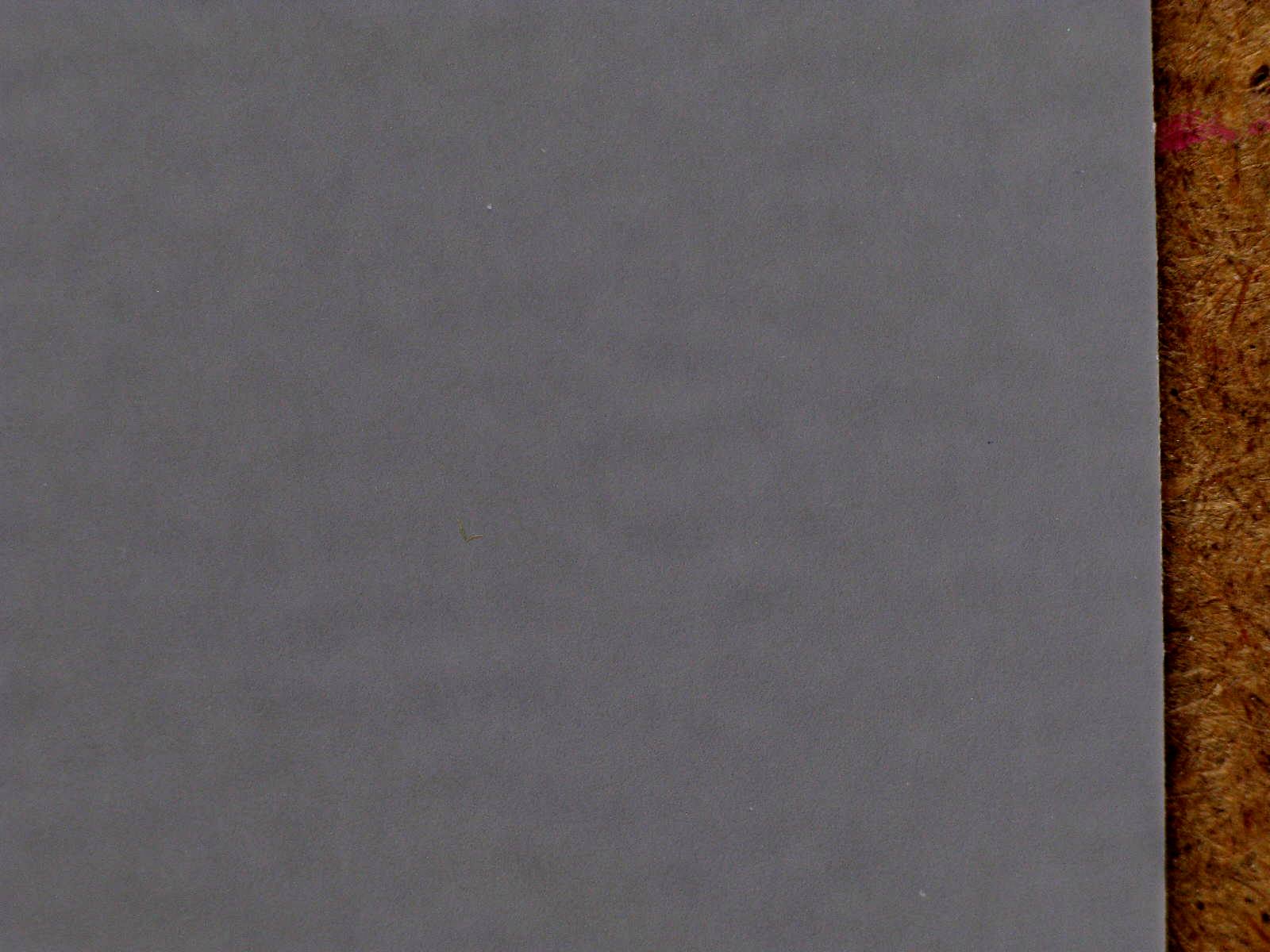

OK, I just completed that trial. Attached are two images of an optimum density flashed MCP 312 sheet to best illustrate the pattern that was evident in the sky of a pictorial images I'd previously printed. The first shows an entire 8x10 sheet and the second is a closeup of the pattern itself.
I don't know whether this is X-ray damage or a result of imperfect coating. Either way, the paper is not usable by me for most of what I print. If/when ADOX begins coating MCP-312 in Switzerland, thereby taking Inoviscoat's coating line out of the equation, and Freestyle imports such new batches, I'll try again. Until those two criteria are met, the remainder of my 100-sheet box will be held aside for any negatives that have fine detail (which can mask the paper's pattern) everywhere.

It is rare for paper emulsions to be affected by X-Ray, but not impossible depending on strength and wavelength. That said, the example here by Sal seems to show a ripple in the coating itself. This can sometimes be proven by evenly wetting the emulsion with something that swells the paper emulsion such as hot water or Thiocyanate solution and then looking at the paper by incident light. The same ripple pattern can sometimes be seen. This is not a definitive test. The real test is X-Ray Fluorescence analysis of silver in the raw stock.
PE

...the example here by Sal seems to show a ripple in the coating itself. This can sometimes be proven by evenly wetting the emulsion with something that swells the paper emulsion such as hot water or Thiocyanate solution and then looking at the paper by incident light. The same ripple pattern can sometimes be seen. This is not a definitive test. The real test is X-Ray Fluorescence analysis of silver in the raw stock...
Thanks Ron. I'm curious, but not enough to even conduct an emulsion wetting test, much less seek out a way to have X-Ray Fluorescence analysis performed. :smile: Irrespective of the pattern's cause, I'll stick to Ilford for now.
