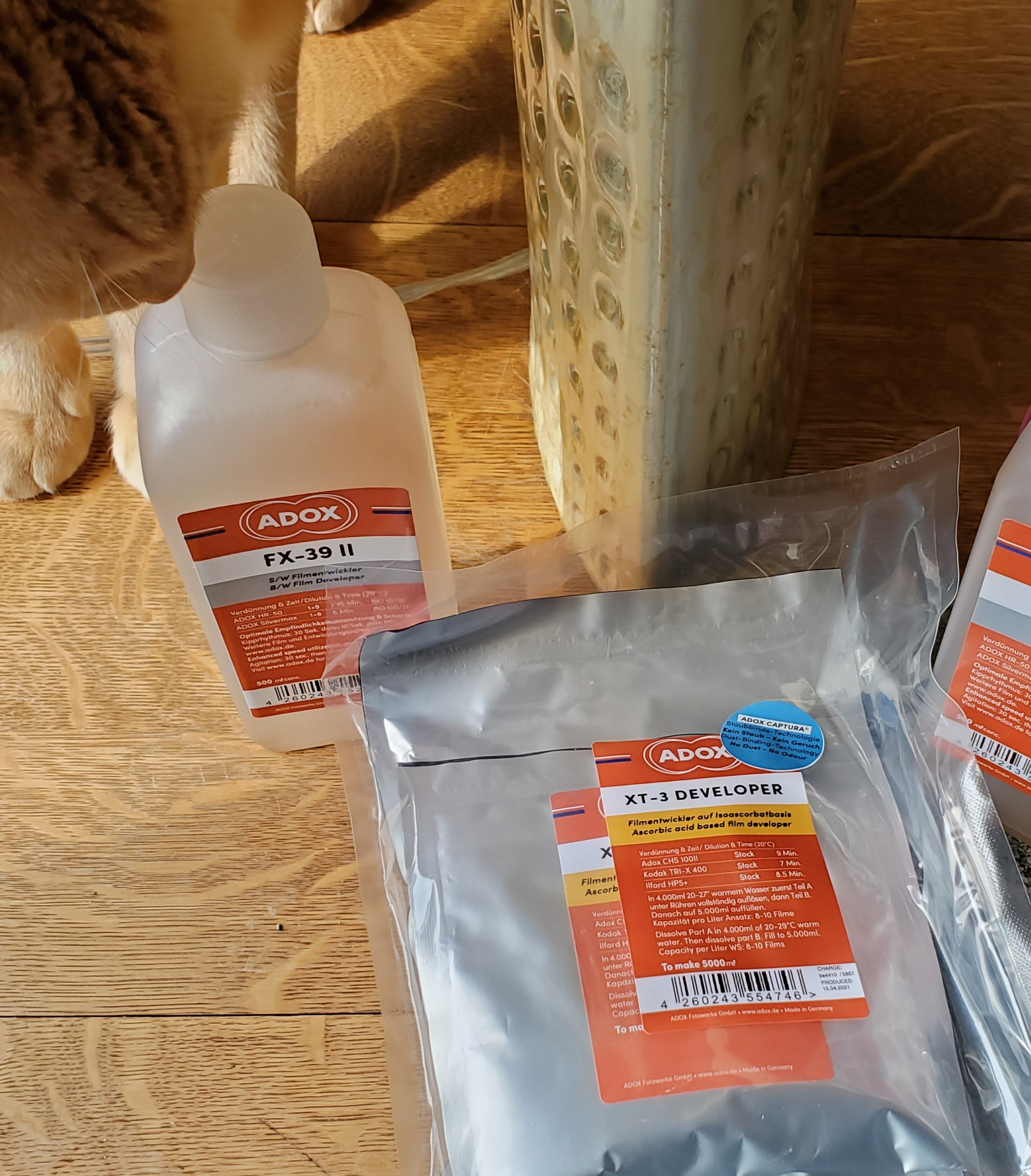

THE GOODSTUFF IS HERE! FIRST TIME WITH ALL OF THIS. LOOKING FORWARD TO TRYING THE XT-3, I'VE BEEN USING XTOL FOREVER. FREESTYLE DELIVERED THIS TO ME YESTERDAY!
QUALITY IS ECONOMY!
