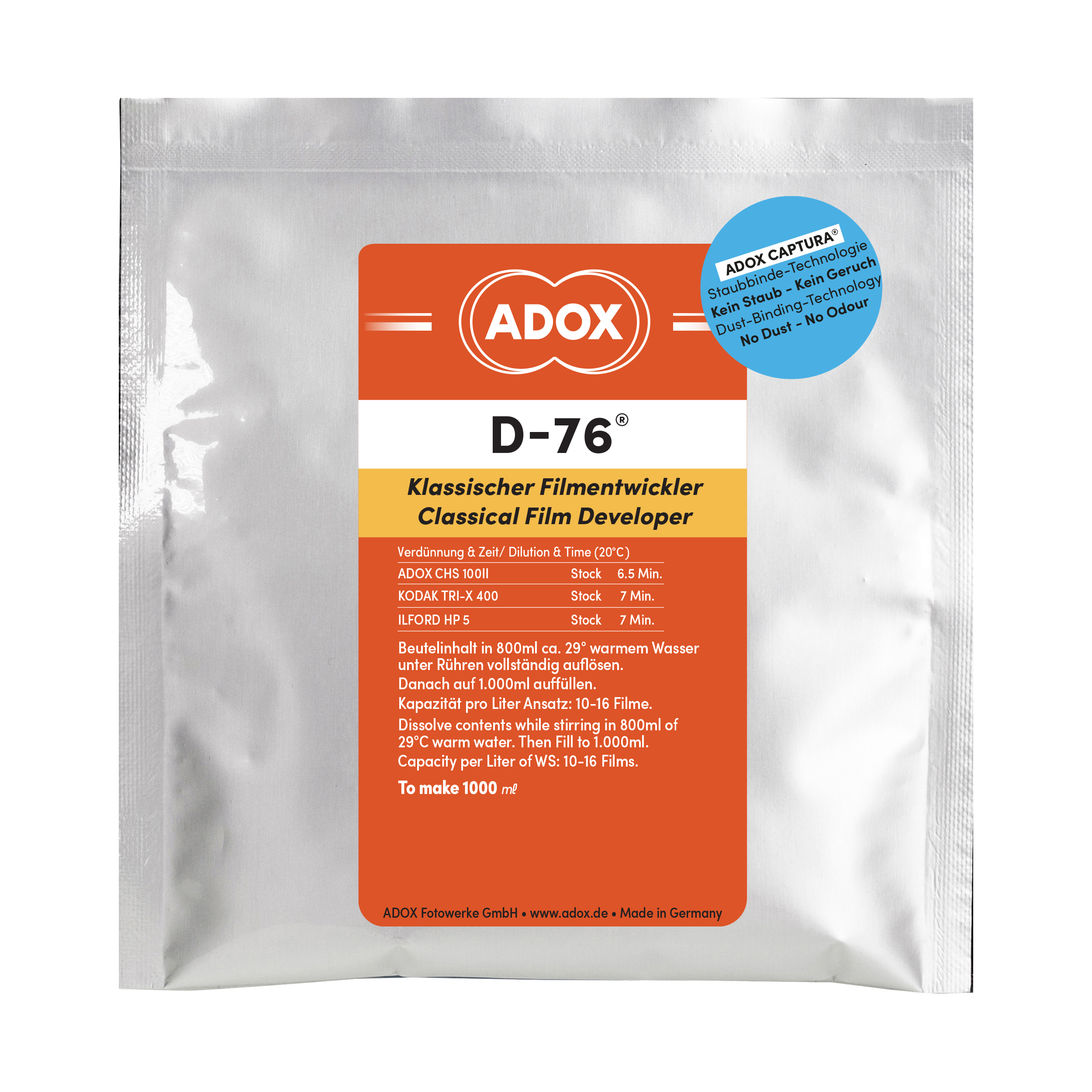

We are proudly announcing ADOX D-76.
It is the newest product from our powder line.
The Kodak “Developer-76” recipe is a photography legend next to Rodinal, gaining almost universal recognition as the go-to developer for photojournalistic work during the WWII and post war era.
D-76 is a universal, easy-to-use developer with a multitude of applications with the most different films and contrast situations, always delivering fine grain and great speed-utilisation.
ADOX took the classical formula and, while keeping all the important original properties and developing times, brought it up to the modern standards. The new ADOX D-76 has significantly lower dissolving temperatures, as well as the Captura® technology for dust-free mixing. Additionally, all the borates were removed and replaced with a non-toxic biodegradable buffer. The ADOX D-76 powder developer is made in Germany, with both research and post-production quality control carried out on site. The product is available in 1l and 5l packs.
The ADOX D-76 developer can be used exactly like the Kodak D-76, with the already-published D-76 times, dilutions and factors.
Available now at FREESTYLE and FOTOIMPEX.
