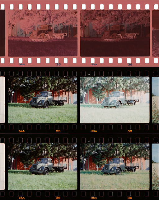

I need to finish my roll of Adox CM. I will make a couple of side-by-side exposures of identical scenes at iso 200 and 25, so if you can wait a couple of days I can give you a preview of what you can expect…
Adox Color Mission 200 at ISO 200 vs 25:
Last row is with the correction to the ISO 25 shot. There is still obvious change in hues and saturation, but it might be passable for some shots...
