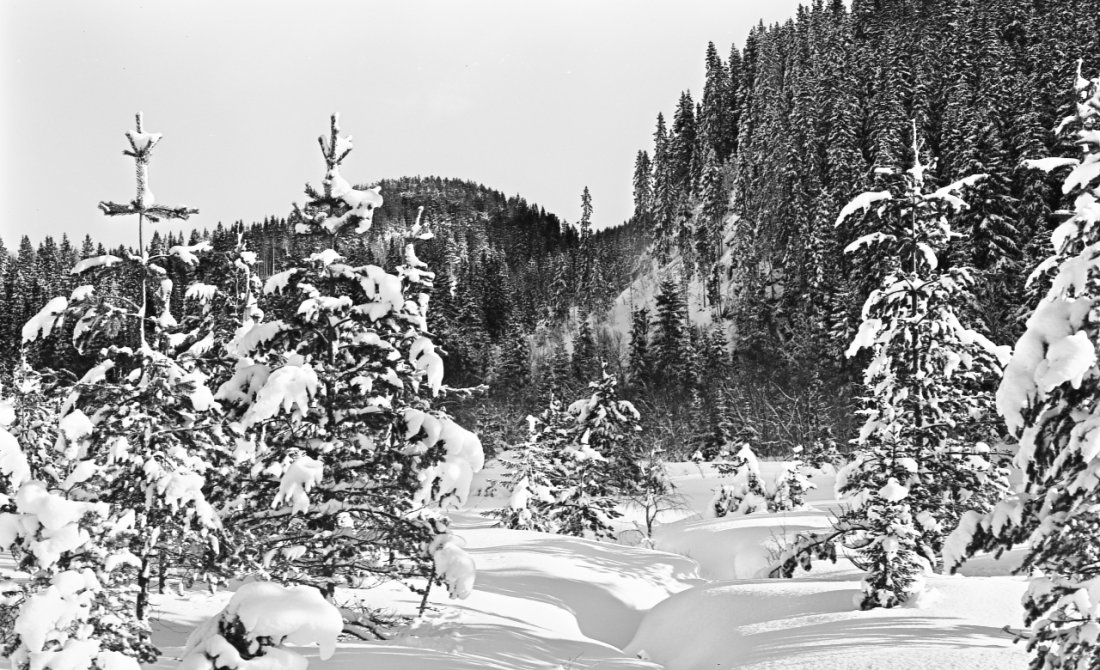

Interesting. I have been trying out CMS20 in my EOS 50 now in the winter, and I find that if I trust the evaluative metering in the camera, it consistently underexposes the film. (Most likely the snow is fooling it) If I meter the ambient light, or use the large spot meter of the EOS 50 and meter the shadows, it turns out all right. I expose at EI 25, and have used a variety of developers, all giving acceptable results, at least for scanning:
1. Fomadon Excel (an Xtol clone) at 1+10 with 1 g/l of sodium metaborate added, 12 minutes. This is the contrastiest of the bunch.
2. The low-contrast metol-bicarbonate developer from "The Film Developing Cookbook" also at 12 minutes. More contrast than I got from Tech Pan + Rodinal, but less than Fomadon.
3. A Stoeckler type two-bath developer with 5 grams metol and 25 grams of sulfite in the first bath. Anchell & Troop says two-bath developers does not work well with document films, but Agfa recommended it, I seem to remember, and it seems to give slightly better shadow detail than the first two developers. The A bath of this developer will develop film by itself, so time in the first bath does influence the results. I used 3-4 minutes.

Just a quick followup. I have now also tried a very dilute Beutler developer with CMS20. 0.2g metol, 1g sulfite, and 1 g sodium carbonate. I developed for half an hour with agitation every three minutes or so. Contrast is a bit low, which indicates that I could have used a less dilute developer, but the shadows are OK. The attached image was exposed at 25 ISO at 1/125 and f5.6.
