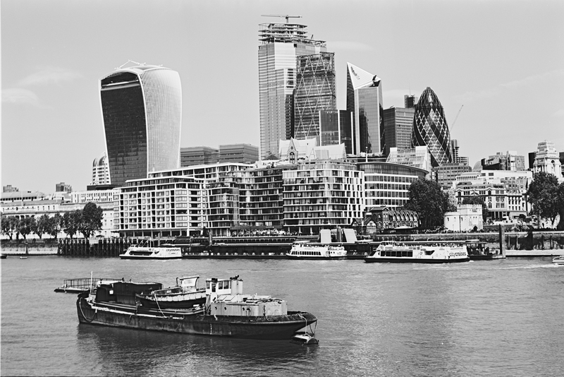

Contrast and resolution is lower with the Pan F+ shots. The grain is approximately the same for both though.
I can confirm from my scientific film tests in my test lab that the resolution of Copex Rapid is significantly higher compared to Ilford PanF+. And indeed, the results concerning grain are quite similar.
Contrast: Is - as always - dependant on exposure, development time, developer and agitation. With both films low(er), medium and high(er) contrast results are possible.

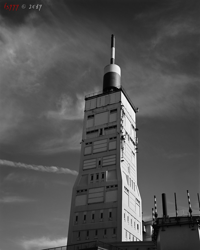

On my first film I obtained good results with CMS 20 II at EI=12 developed in TD-LC 103 11m 20C, fix 1min, wash 5 min.
TDLC-103 is the best homebrew for CMS 20II I found so far, none of the negatives had uneven skies.

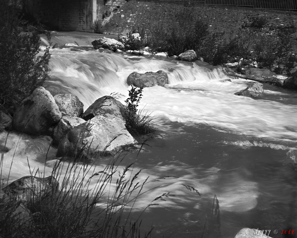

I am developing CMS 20 II (20 ISO) in Caffenol CLCN.
For 1 120 film
500 ml Filtered Water
5gr Anhydrous Washing Soda
1gr Vitamin C
6gr cheap Instant coffee
60 sec. slow agitations then 3 times every 3 minutes for 15 minutes, fixing 60 sec.

Nice results. What EI? What temperature did you develop at? I also had nice results in Caffenol-LC version.
Thank you ! 20 ISO. 20°C/68°F. This a different version CLCN from Philippe May.
