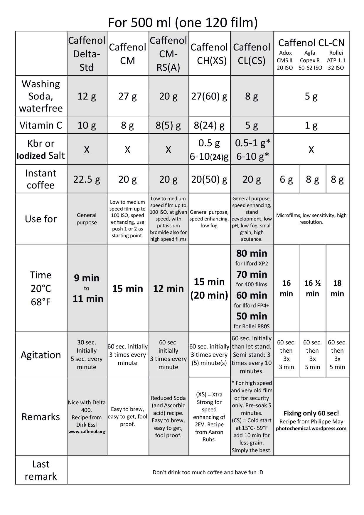

When I last used the original CMS20, I got an honest EI 20 with Caffenol LC+C -- a low concentration Caffenol (half the original amounts of coffee and ascorbate, as I recall), and grain I couldn't see in an 8x10 from 35mm.
I had completely forgotten Caffenol! Many thanks for the advice on coffee/ascorbate! At least I can easily find the ingredients fro caffenon where I am these days.
Thank you!

@fs999 Your link is broken -- either that, or my work computer's network is blocking the site. Looks like you need to add the https:// (or http:// if it's not a secure page).
fs999
May 3, 2010
401
Luxembourg
Sorry a d was missing. My site provider is asking 500 € per year for https. There are no data gathered so no need for encrypted transfer.

Ah, works well now. Nice compact format, everything needed to mix and use Caffenol once you understand the concept.

Thank you !
The Facebook group Caffenol, founded by Dirk Essl (Delta-Std and Delta-Micro recipe), is also a good source of knowledge.
