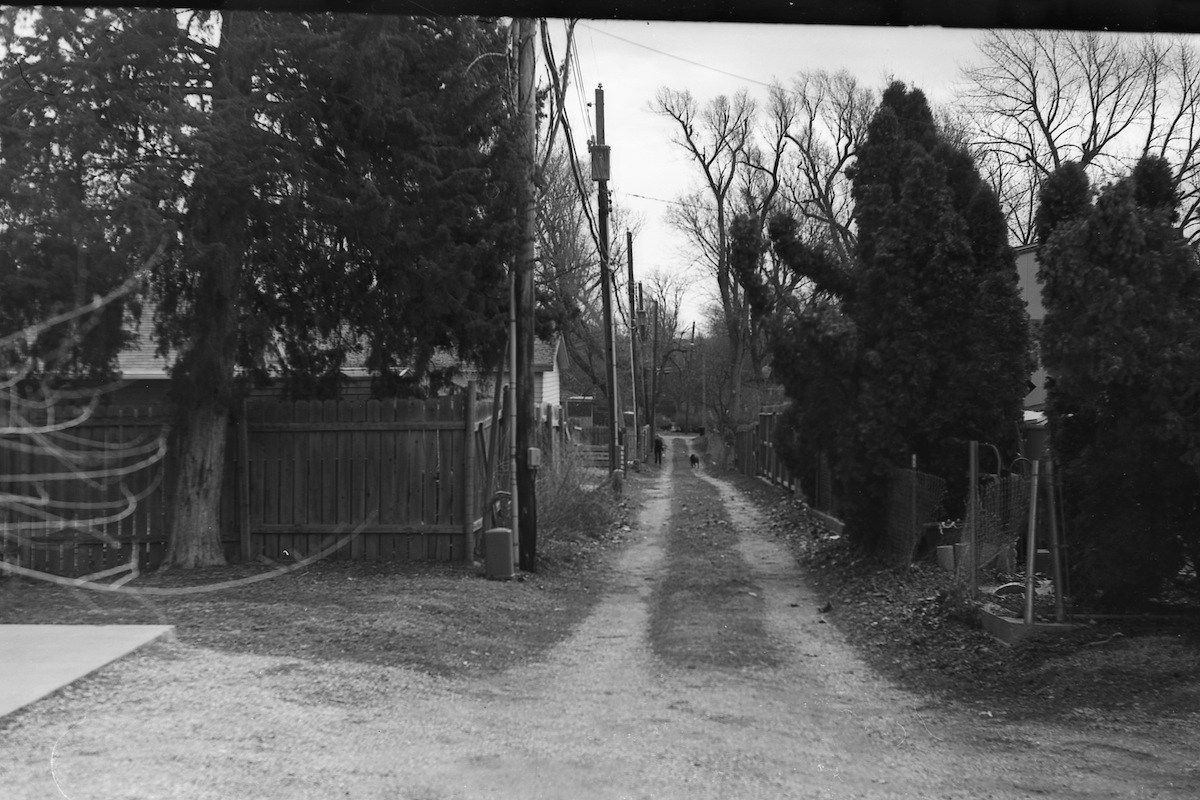

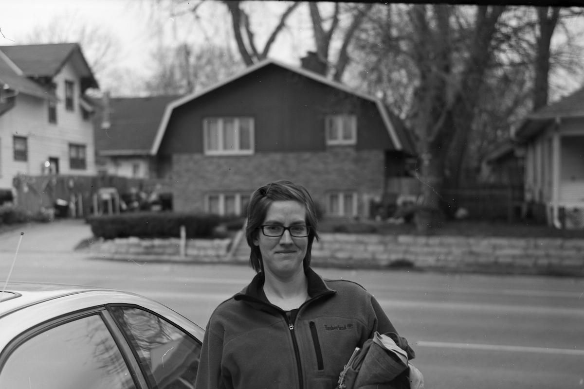

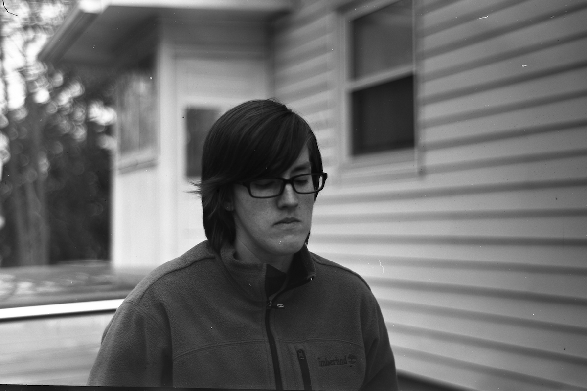

Wanted to share some success with Caffenol LC+C. Dead Link Removed
Contrast is controlled to a greater degree than with the LC. I souped it for 12 minutes rather than the recommended 15 minutes ... and probably could have done a little less. Exposed at box speed.
These were taken with a 1960 MIR (FSU) with a 1953 Jupiter-8 LTM, recent acquisitions for me. And this was a test roll for the camera/lens as well as the developer. Negative scans on V500 at 1600ppi.
