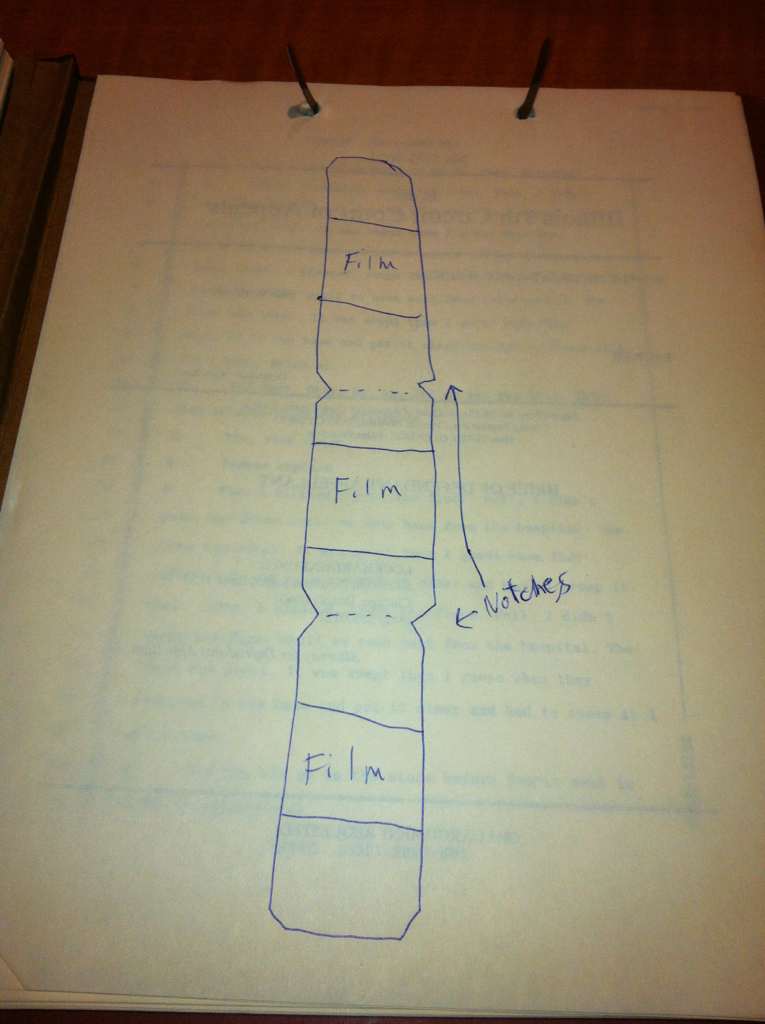

What about making uncut 46mm spools like Ilford does? We can hand roll.
OR better would be to roll it WITH backing paper as a continuous roll of paper but the emulsion spaced out with notches in the paper where we cut in the dark and can hand roll onto spools without worrying about being off with the emulsion placement and numbers? Possible?
That would need new machinery.
Another alternative would be cutting 46mm film rolls and 46mm backing paper and selling both rolls as a set.

The reason for the 120 delay is caused by our large slitter needing to be converted to 61,5mm. Takes some time.
The small slitter is not fit for film anymore. We only use this for backing paper now.
46mm would be another adventure. We have no backing paper with the correct numbers printed on.
