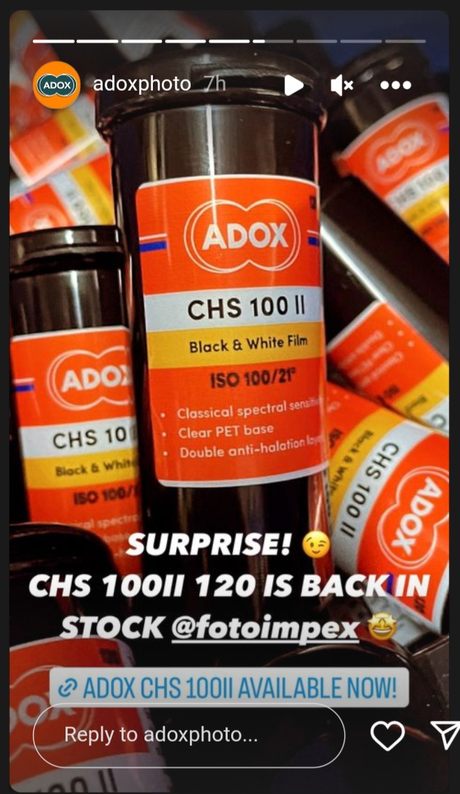

Adox just announced on their IG that CHS 100 II 120 is back in stock at Fotoimpex
