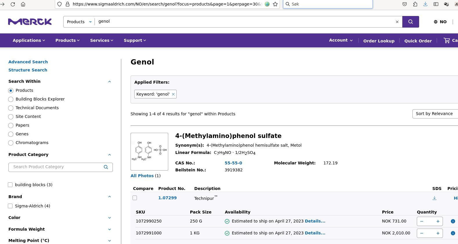

so I learn that:
1) reagents for photo chemistry isn't sourced from Europe (!)
2) industrial quantities are more expensive than hobbyist ones. Very well, I am glad to learn, yet I am puzzled because here is what I get on Merck/Sigma-Aldrich for metol ie. 4-(Methylamino)phenol hemisulfate if I buy in Norway:
https://www.sigmaaldrich.com/NO/en/...age=30&sort=relevance&term=genol&type=product
250g : 731 kr
1 kg: 2010 kr
hydroquinone 1 kg: ~1000kr:
https://www.sigmaaldrich.com/NO/en/substance/hydroquinone11011123319
earlier today I mixed 1 liter of Gevaert G-201, it has 1,5g metol, and 1 liter Kodak D-19, 2 g metol. Other reagent is hydroquinone, 6g and 8g respectively, there's the potassium bromide 2g and 5g, and the sodium carbonate is from the box of "krystallsoda" sold at the supermarket.
so all together a liter of developer doesn't cost me 80$/€ .. 80€ is the price of 250g of metol.

what I learnt from your former comment and @Tsubasa one is that buying large quantities of reagents like ADOX needs to do in order to manufacture their chemistry costs more proportionally than for a hobbyist to buy a small amount like 100g. And that, ADOX or/and others like Tetenal they are looking at Asia to source chemicals.
I documented with links on Sigma-Aldrich/Merck that 1 kg metol costs me ~2000kr and 1 kg hydroquinone ~1000 kr, one liter of MQ developer contains few grams of each. There's the potassium bromide, the sulfite, the carbonate. All together one liter isn´t in the 80 €/$/£ as @Tsubasa suggested, very far from it.
I provided the links, here a screenshot for metol:
Merck/Sigma-Aldrich is a main chemical industry in Germany and Europe.
Of course it is very possible that their rates for big quantities required by ADOX are still significantly more expensive than buying it from Asia, which means I guess from China or India.
