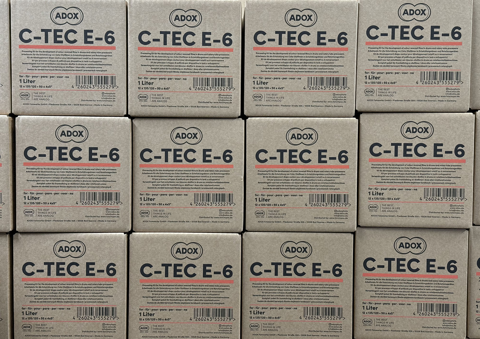

Our new C-TEC E-6 Kits are now shipping from our facilities in Germany. You can order online or wait for it to be listed at your distributor of choice. Many distributors orders are also shipping out today.
Thank you everyone for supporting us and posting in the Thedodor Teichgräber revival thread. The top two picks are back now.
