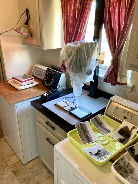

I also had fogging with Foma papers using an OC safelight. I now use a JR Lab 15 watt bulb and that fixed the paper fog issue.
