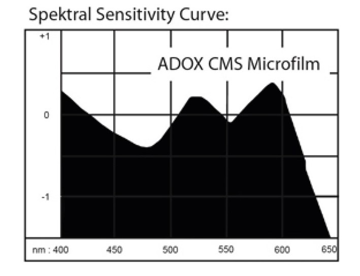

CMS 20 II has red sensitivity, but less than say, HP5.
It's certainly not ortho (red blind), but its red sensitivity is far less than almost any panchromatic film. ADOX describes it as orthopanchromatic. That's how Fuji characterizes ACROS, but Fuji's product doesn't start down until 650nm, while CMS 20 II begins to fall off at 590nm and is already 1-1/3 stops down at 650nm.

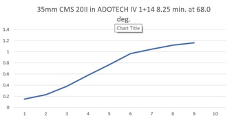

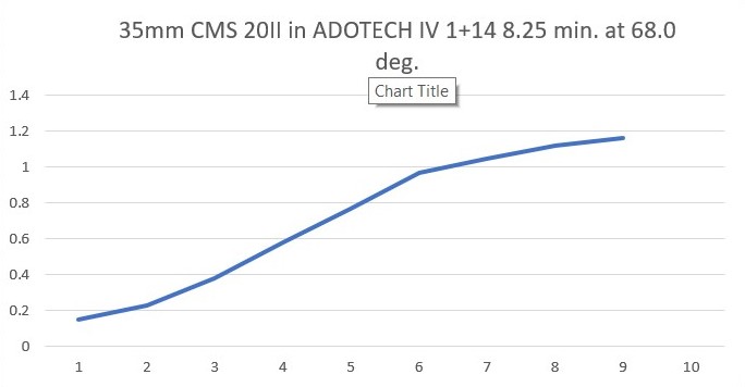

A half year later, I decided to do a more controlled test of CMS 20II in Adotech IV. It took several trials to zero in; I ended up at 8 minutes 15 seconds @ 68 degrees F, using ADOX's recommended processing regime, for an EI of 6 and straight line-portion CI of 0.62. The characteristic curve is attached. It represents zones from I through IX. Fb-f was 0.04.
The developer seems to have no aging problem; it's down to 17ml in the 100ml bottle now and I detect no sensitometric difference between this trial and earlier rolls. ADOX uses bottles that have small nubs on their openings' restriction plates that prevent caps from being tightened to airtightness, so squeezing them to expel air doesn't work. Adotech IV appears not to care.
