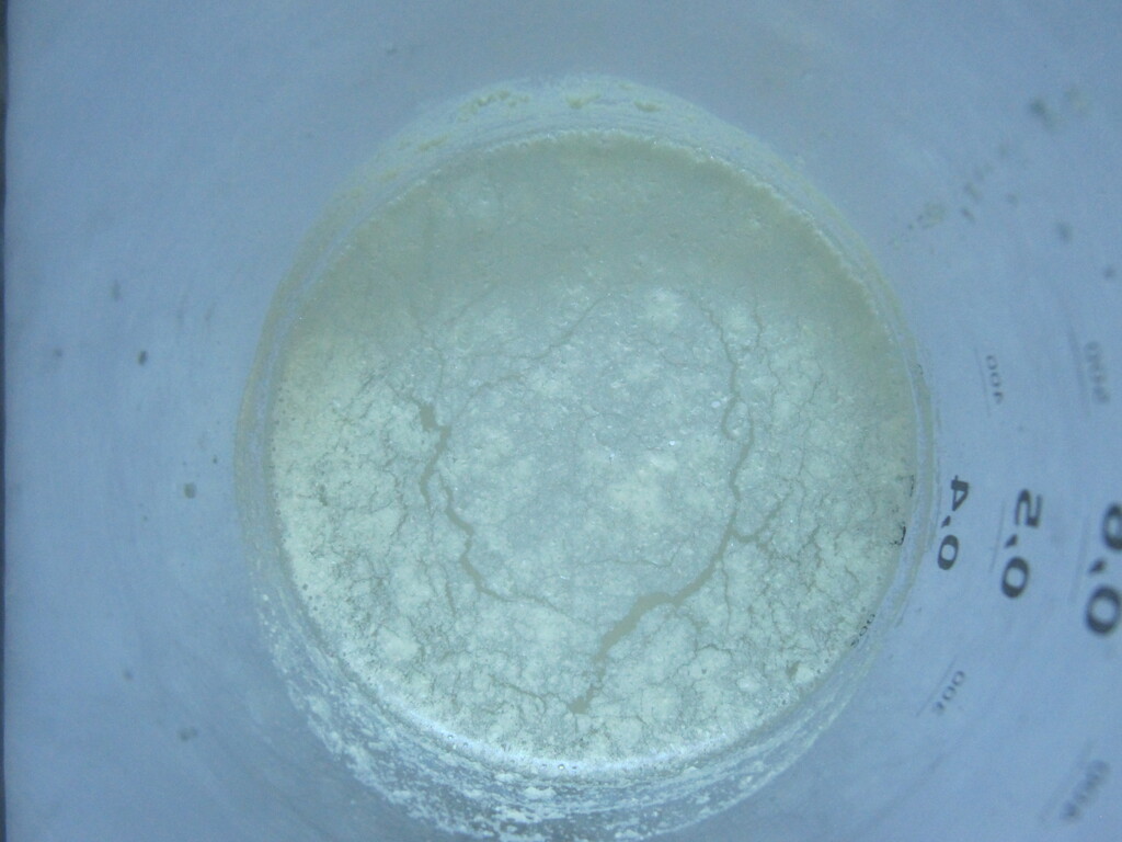

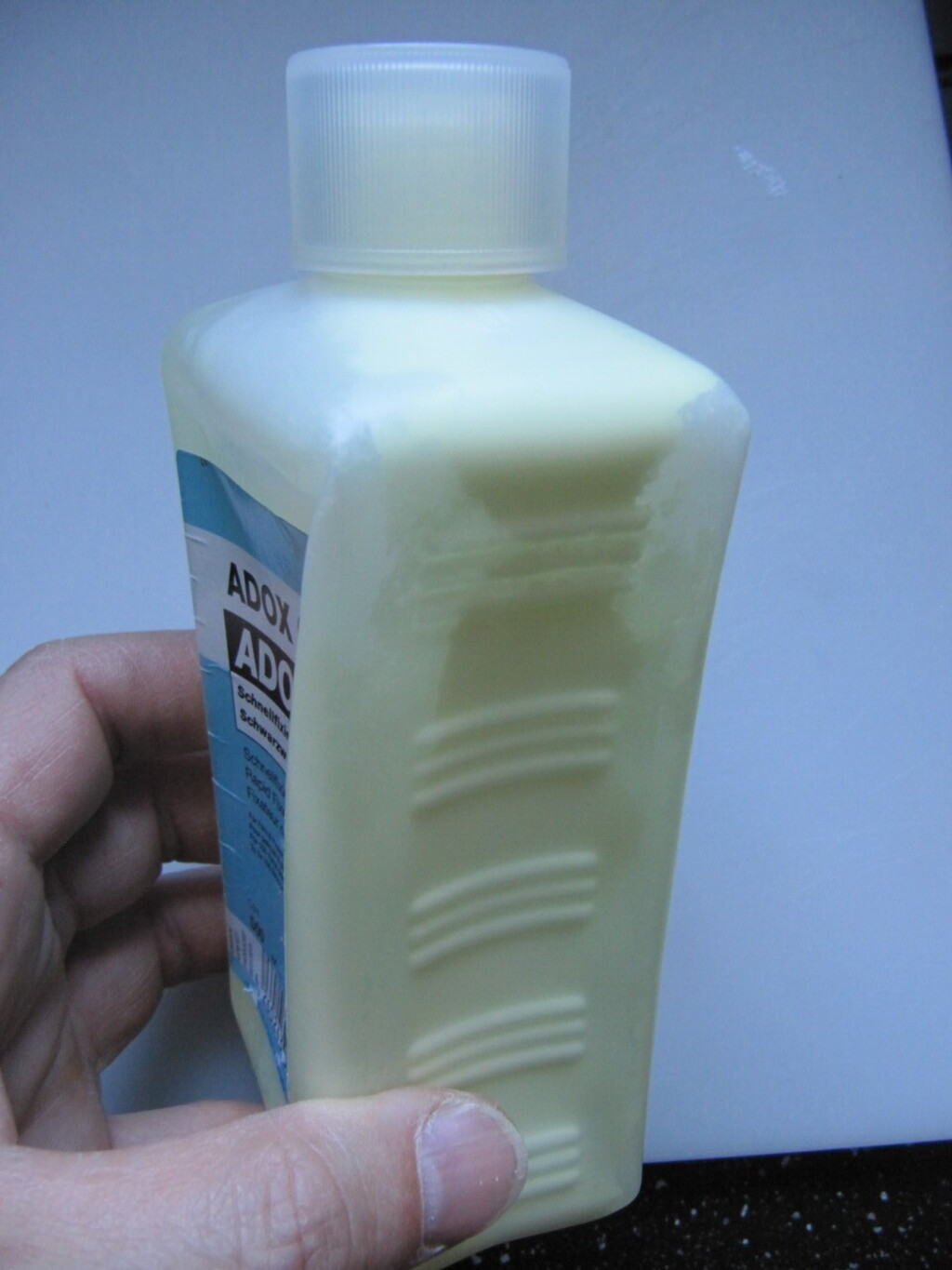

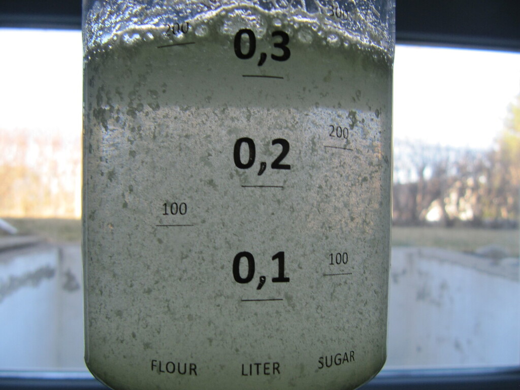

One and half month ago I got chemicals from a girl who briefly tried home development, a basic set with Rodinal, Adofix and Adoflo, ~90% full, a bit only had been used. Superficial visual inspection was ok, no precipitates, fog nor miscoloration, and I have used quite some of the Rodinal, no issue. I had enough mixed stock fixer already so the Adofix stood in the fridge. This morning I was to mix some of that Adofix, but ... solid residues, mostly all along the side of the bottle that was against the back wall of the fridge, ie. colder, yet not freezing. I shaked it well after I let it warm at room temperature, but these are precipitates, so I will just discard it:
this fixer is the one with blue label, not orange, my bottle says "Adofix" and currently on Adox site its label is "Adoxfix Plus", no idea if the "Plus" is just naming or if there's a difference:
First of all you should contact Adox / Fotoimpex on this first rather writing here.
Second: you have probably frozen it and that is below storage temperature (5-30 deg C). Freezers back walls are typically below zero celcius.
Lower temperatures can promote precipitation. High temperatures can accelerate breakdown of thiosulfate generating solid sulfur. Low pH levels do the same. In fact, it's quite remarkable that most fixer takes at least a few months to break down into a sorry mess at all!
Don't fret over it. Next time just keep the fix out of the fridge and enjoy it while it lasts. If you're dissatisfied with a particular product, try another one.
FWIW: most decomposed fix I've tried still fixed fine although of course with reduced capacity.
I didn't notice Fotoimpex does mention on their site (not on the bottle) Treten Ausfällungen oder schwefeliger Geruch auf, ist das Fixierbadkonzentrat nicht mehr einsetzbar. so their recipe is indeed probably more sensible to precipitate/flocking.
