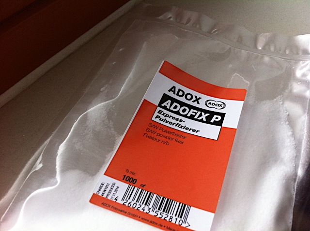

I ordered some Adox Adofix P powdered fixer but sadly it didn't come with any instructions on how to mix it or use it.
Their website offers no help either. What I'd like to know is;
1. how do I mix this stuff (it says 'to mix 1000 ml' on the package) ?
2. how do I use it once mixed (dillutions?) ?
I know that perhaps these are silly questions but I'm honestly a little clueless. I've never used a powdered fixer before.
All help is appreciated thanks.

Richardo, the page you linked to belongs to a different product. Adofix P needs longer fixing times, no idea why.
This what the package looks like. On the back are only some warnings but no instructions. Got it from fotoimpex.
Let's say I dissolve this in 1000ml of water to make a stock solution. Does it still need to be dilluted then (1+4 or 1+9) to make a working solution?

Thanks, its says "Pulverkonzentrat für 1 Liter Gebrauchslösung" on the fotoimpex site. In other words it just a matter of mixing it with 1000ml of water to get the working solution.

Thanks all for your replies. It tried it this afternoon by simply mixing it up with 1000ml of water and no further dilutions. It worked just fine. Still I think it's annoying that no instructions are given on the package.
