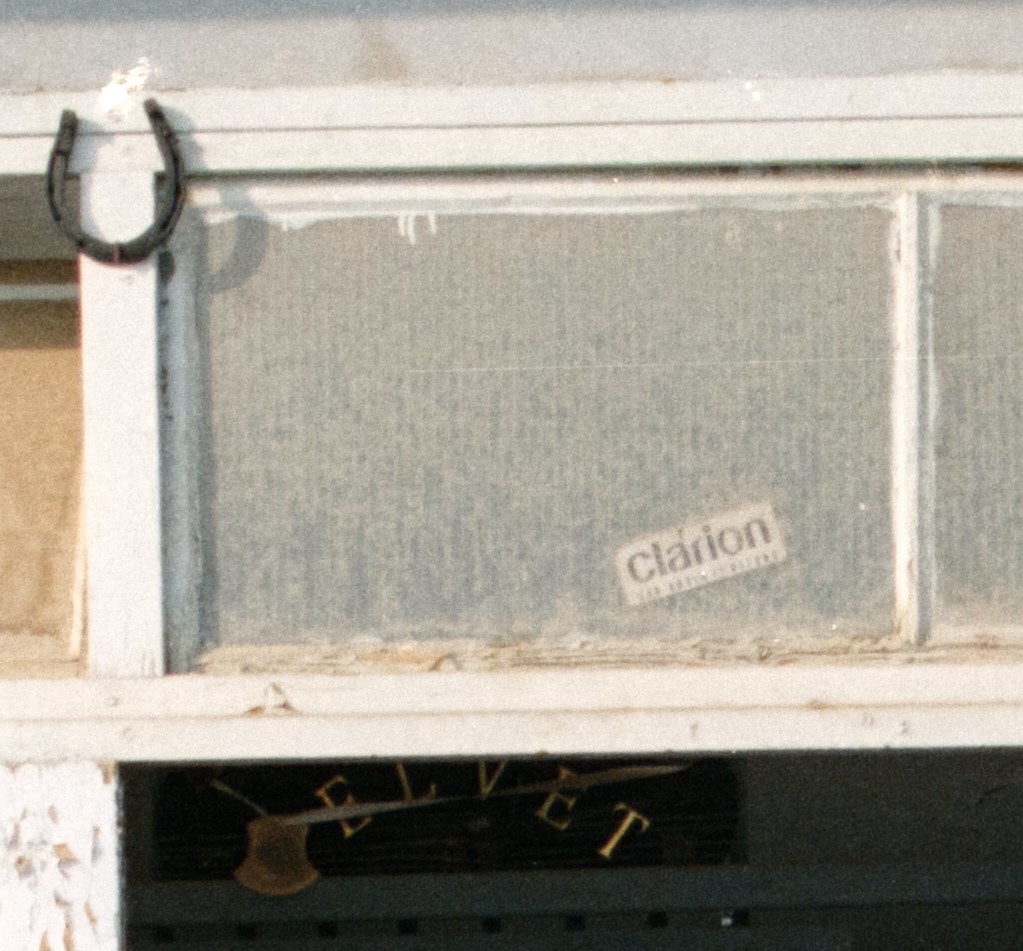

200% crop of Olympus E-M5 II "pixel-shift" resolution scan:
200% cop of Olympus E-M5 II "standard" resolution scan with ACR super-resolution:
