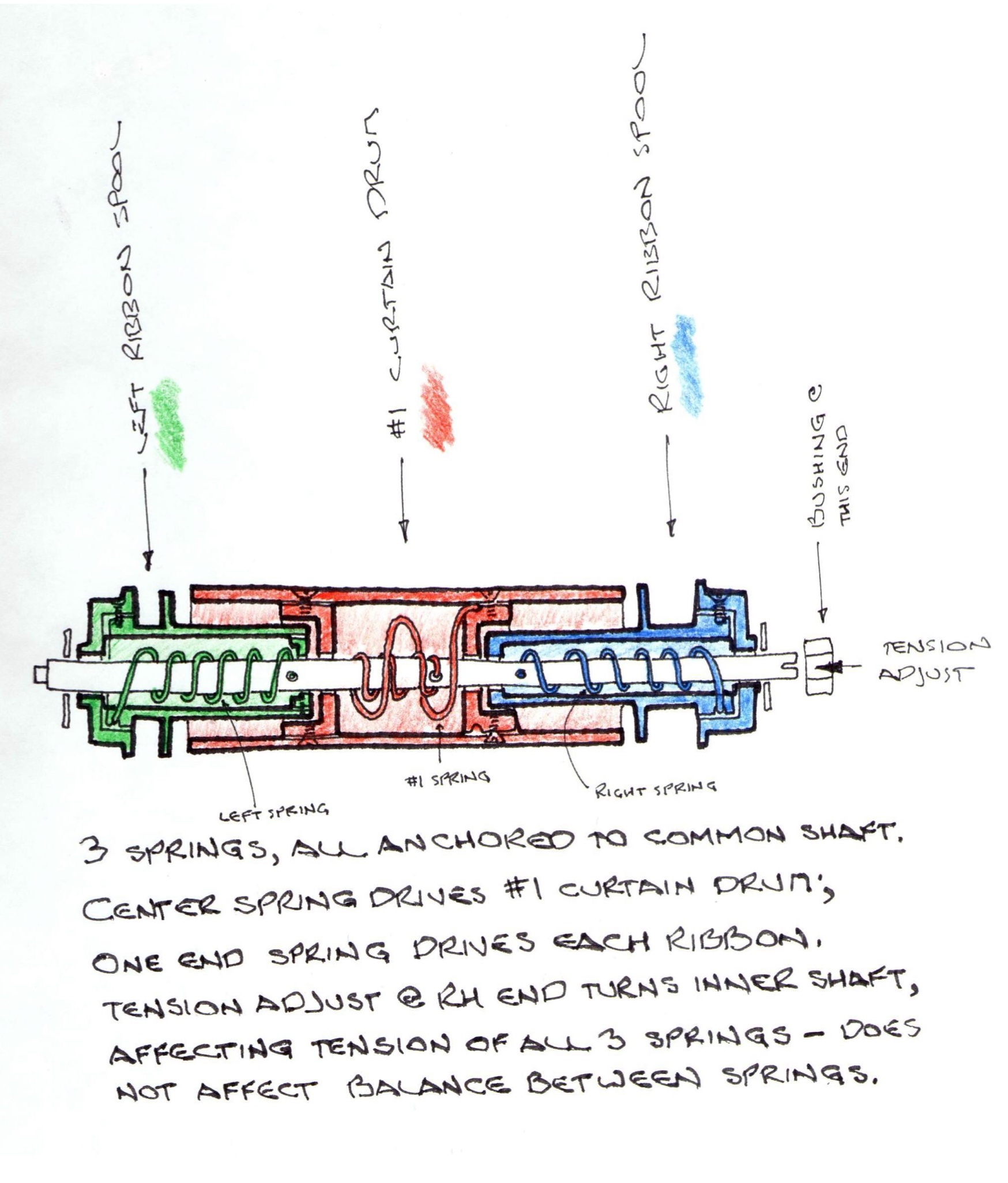

Does anyone know of a youtube video or a website that shows how to adjust the tension of the first curtain? I know the second curtain can be adjusted with that screw on the side that rolls the entire lower curtain roller. But how can I decrease the tension for the first curtain?
Have you seen this drawing from the internet?

I don't think you can (alter the springs individually).
Yep, you can't change them individually. The whole thing runs on one roller with tree individual springs (as per the drawing).

But shouldn't there be a way? I read somewhere that it is common that with age you have to tension the roller more and more to get the speeds to the normal timing (otherwise they become too short). In my case I got the timings right but I think the tension is very high, because the sound is quite loud, normaly the contax IIIa should be more quiet I think. How can that be remedied? Or do I have to disassemble the roller to clean the springs or eventually shorten the central spring to get more pressure on the first curtain compared to the second?

For the spring tension, there is only one adjustment, there is no individual curtain tension. This due to the design of the shutter, which verges into genius.
