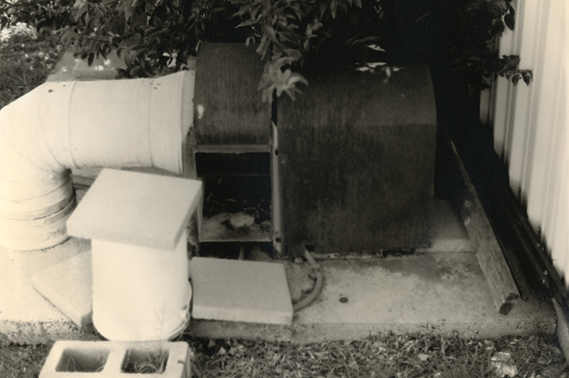

Well I piddled around throughout the day. I was taking a normal exposure, one with a red filter(curious) and one 2 stops over exposed. I developed for 9 mins this time.
Looking at the film against the light the 2 stops over exposed is waaaaay better....Much better blacks. But like you said, it's what it prints like. I'm guessing it will give me much more latitude. Stay tuned ;-)

Much happier with this combo.
This is a straight print no contrast filter. My scanner is making the blacks a little darker than they are, but I have nice black and whites. With a little dodging and burning I can work with this. As far as a histogram goes, yes you can see that the blacks never made it to black on the normal exposure but did on the overexposure.

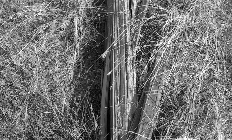

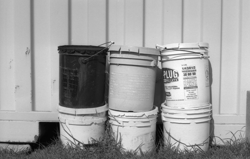

Scanning these things seems tough but I think I got it down finally. These are from the test roll of panf+ shot two stops longer (EI 12) and processed with rollo pyro for 9mins. I like the tonal range I'm getting. Excited about shooting more meaningful subject matters. Also, I might try to enlarge these tonight to see how they print.
