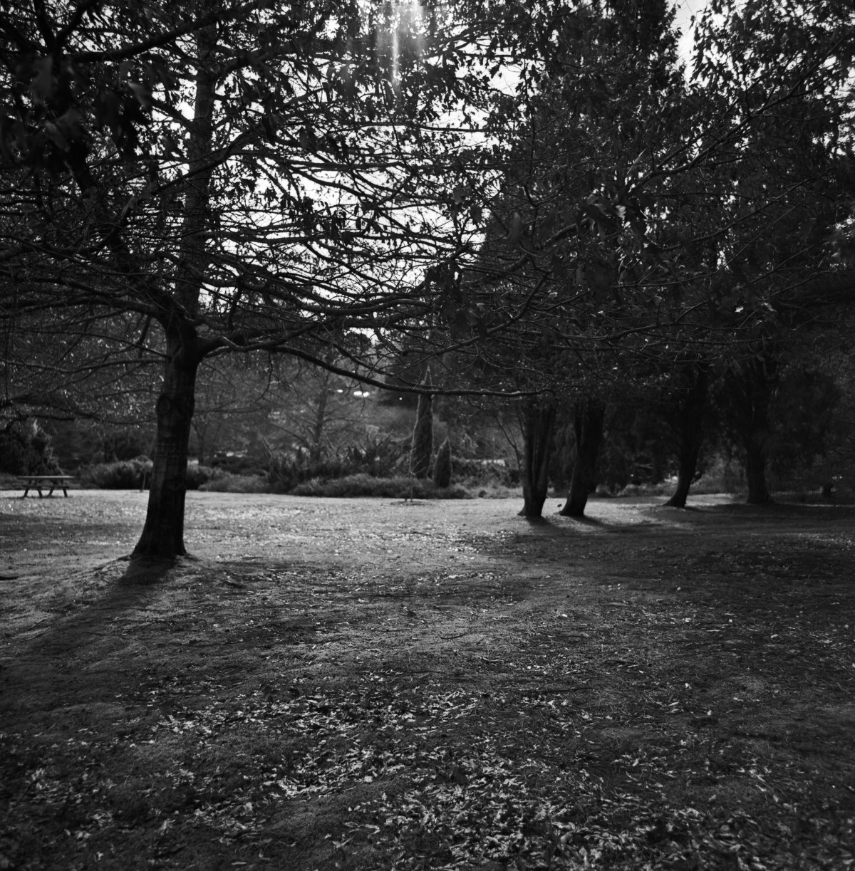

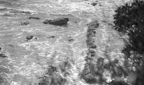

I've shot FP4 (non+) and Panatomic X both with expiry dates in the 70s. Both at maybe 1/2 - 1 stop below box-speed, both in Caffenol-L-C (by the book with about 1g/l of KBr) for about an hour with a few inversions occasionally.
Both are some of the most perfectly developed negs that I've got, much better than a lot of stuff I did in 'real' developers with time and temp measurements and everything.
ps, like this one, this was FP4 from 1979:
attachment.php
Just a neg scan so far, but I'll print in properly one day.

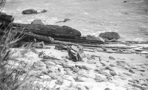

When I say 'by the book', I mean this one.
So (for 120 film in a Paterson tank):
500ml of water (I just use room temperature Puratap filtered).
8g Washing Soda (pure) and stir a few minutes until dissolved
5g Vitamin C and stir a few minutes until dissolved
20g coffee (Woolworth's home brand gutrot) and stir a few minutes until dissolved
As near to 1g of KBr as I can, anywhere 0.7 - 1.3g in reality because it's hard to measure such small weights, and stir a bit (more KBr mean less fog, but less developing activity)
For measuring, I got some scales from fleabay, like this one.
Maybe leave it for 5 mins to make sure that everything's dissolved properly, but I don't wait an hour for it to be fully room temperature again (one of the reactions is exothermic and it gets hot, or something).
Just pour it in and invert a bit, 20-30s or so.
I don't do the 1-2-4-8-16-32 minute inversions they suggest, more like 5-10-20-40 if I'm even that organised. Usually I pour it in while I'm making dinner or watching TV and invert when it's "been a while".
Nominally 1 hour, sometimes 50mins if I'm impatient, this film may have been 1 hour 20 because I got distracted.

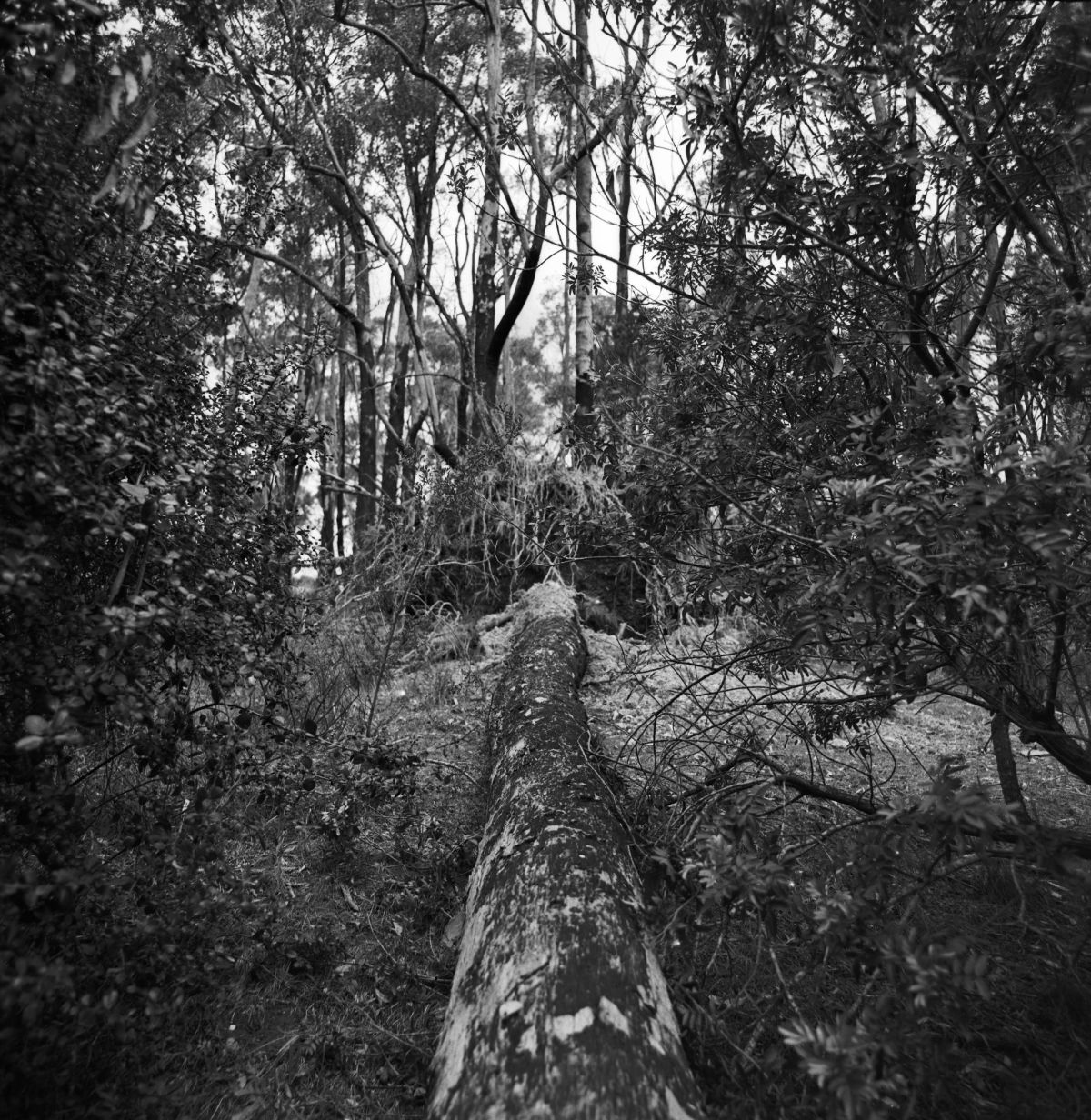

Here's another from that roll that I really like (definitely going to print this one day, when I decide whether to crop out the flare or leave it in):

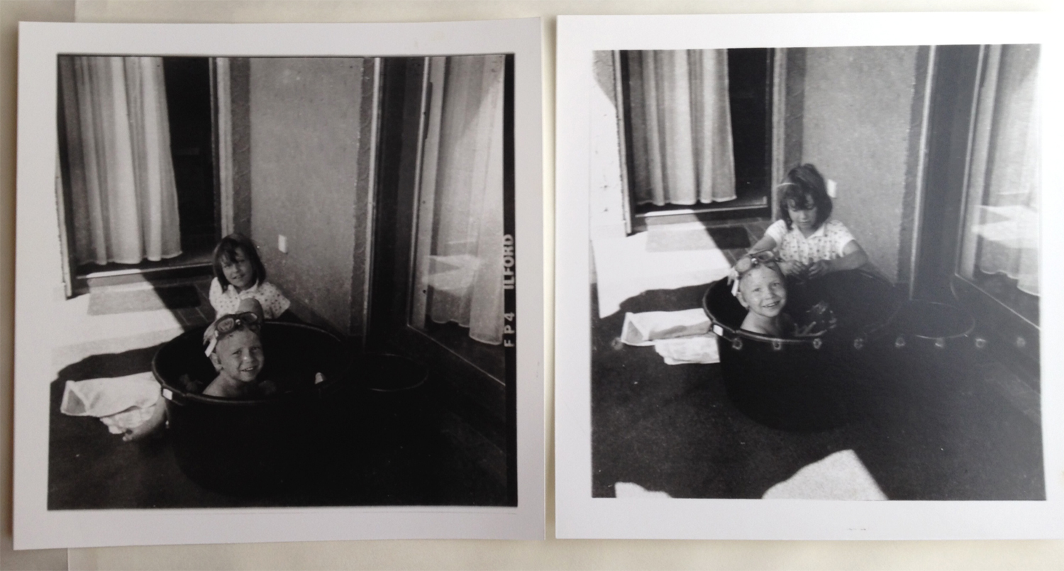

Thanks Simon! I used D76 1:1 for 13 minutes, (added +2 from recommended 11 minutes), took a clip test, thought the result was too thin, and added another 2 minutes for a full 15 minute development. I guess I wouldn't have needed those extra 2, since the thinness of the clip test was more likely the result of my underexposure than underdeveloped film. The first two frames from the 1980s turned out quite well! Didn't scan the negatives yet, but here's a picture of the 15 x 15 cm prints I made, photo from my phone is a bit blurry.

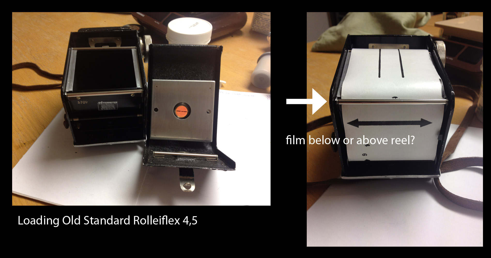

Unfortunately, I didn't pay attention to how the film was loaded when I took it out. I've done a bit of research and found people showing the film going under one of the metal reels in newer Rollei-models; though where their cameras have a metal reel, the Old Standard doesn't have one. I've tried putting film below and above another reel (see picture attached), below seems more tight but a lot closer to the edge - I'm assuming that this might damage the film and might not be necessary, because the metal plate that sits on the inside of the back of the camera already adds a bit of pressure; but then I guess I'm quite confused right now.
Hey Croubie, thanks for sharing! In the end, I was too scared to try my first caffenol on this potential treasure. I did however try developing two test rolls, one Kodak TMax 400 and one Kodak Ultramax 400 with the Delta-STD recipe with doubled amount of Vit. C: 1l water, 24g soda, 40g Vit. C, 45g coffee. (http://www.caffenol.org/recipes/ or Caffenol cookbook page 17) I developed for 11 minutes, as the development chart suggested, and the results were very thin. I was barely able to make out the borders of the negatives, far harder on the Ultramax. So I guess there was some development, but very very little. As I'm looking at your times, I'm wondering if I should have developed far longer than that.. those were newly exposed rolls, the Ultramax being expired sometime in 2012. It could also be my carelessness about the whole experimental approach: I had to mix two different coffees (both caffeeinated), since I didn't have enough of one sort; and I agitated about once a minute, and did not follow any scheme. After mixing together the developer I let it stand for about 30 minutes, where the recipe suggests only 5 minutes. In spite of all these differences from the recipe, I wasn't expecting this to have such a huge impact on the result. I'll think about trying out a different recipe, or giving it another shot when I feel more like caring for exactness. Any thoughts here? Also, any experiences on Ilford HP5+ (120 and 35mm) in Caffenol greatly appreciated :smile:
PS: I vote for leaving in the flare!
