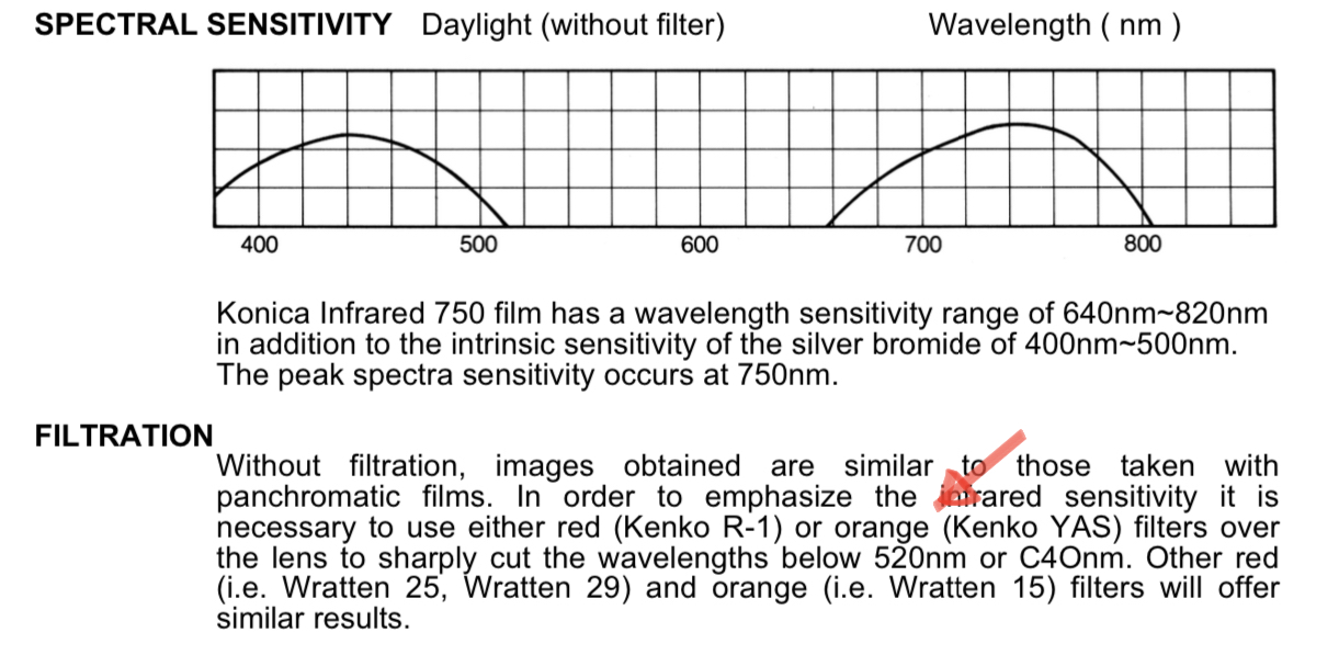

The only thing that would be nice, would be the hole in the spectrum. That is, the green and lower red sensitizers omitted. That would allow not using an expensive IR filter that blocks the view on SLRs.
I'm wondering if blue wouldn't then overpower any IR response the film could provide. Because I interpret you saying that the blue sensitivity remains, but light at that frequency carries more energy.
Helge
Jun 27, 2018
3,938
Denmark
You’d use a yellow or orange filter as with Konica 750 or HIE.
Sirius Glass
Jan 18, 2007
50,814
Southern California
That is a real waste of hard to find discontinued infrared film, especially since the manufacturers' specify using any of a number of red filters. But what the heck, you know more about how to use their film than any of them did.
Helge
Jun 27, 2018
3,938
Denmark
Read the data sheets. They suggest using weak filters. It’s “good enough” for Woods and Rayleigh black out effect.
FWIW I haven’t shot either film.

With HIE, a yellow Wratten #12 was enough to get Wood Effect. I shot a lot of it in 4x5 in the 90's and early 2000's. I still have a box, expired in '67, that works perfectly fine... albeit a bit of base fog, and a speed loss of three stops... not a waste of time, if you can find this film. I also shot a lot of Konica 750. If you want wood effect, a #25 will get you in the ballpark. #29 is better. 720 filter is the best. There are a lot of similarities to Rollei IR.
I have shot HIE with Red23, Red25, Red29 and 720 and each provides its own rendition. I have not use my stock of Konica 750 yet.
