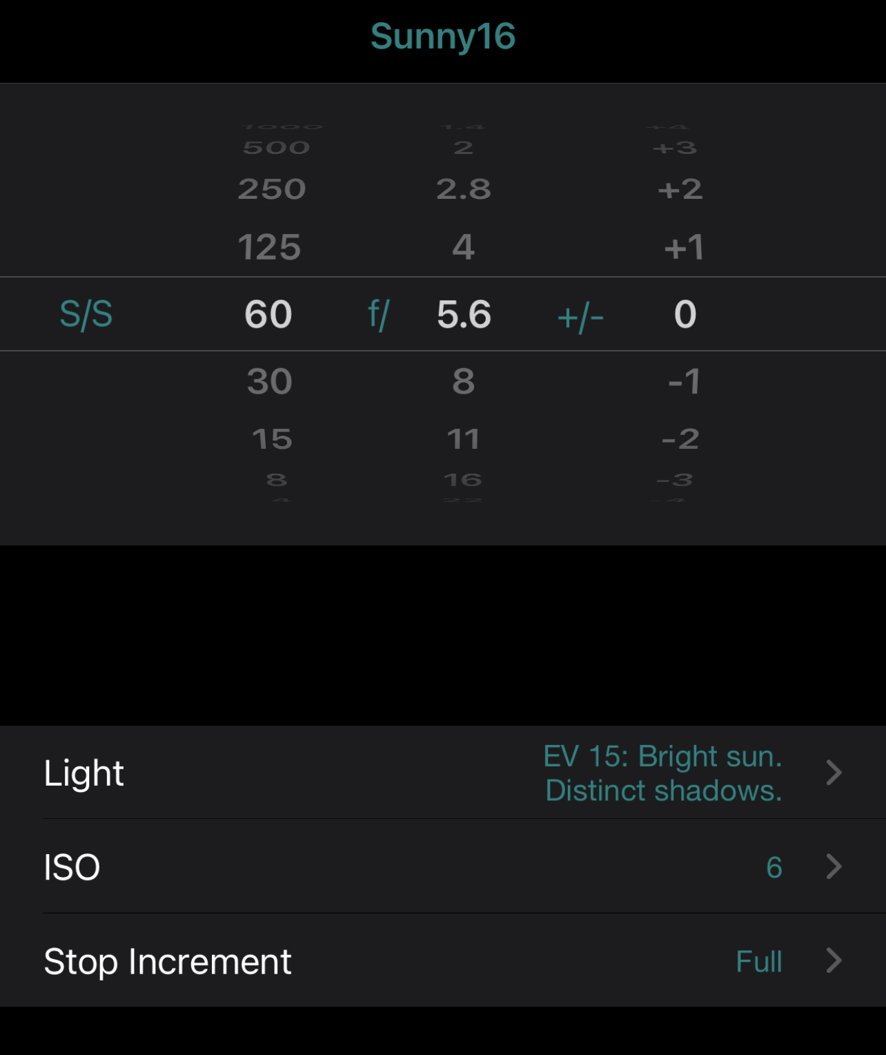

I’m interested to see how you guys calculate the exposures you need. With my film, I just meter at 6 ISO on a clear sunny day and the results are phenomenal! I can usually get sub-1 second exposure times to boot. Hearing some of you saying stuff like 30 seconds exposure makes me think I might be doing something wrong!

You should be able to do better than merely sub second. Handheld should be easily attained in good light.
ISO 6 for slow Aviphot and 10 - 12 for higher speed Aviphot derivatives.

My exposures can be anywhere from 1 second to 24 and even longer, depending on the light, and especially, what aperture I decide to use... Usually smallish, especially with 4x5. EI's are usually 3 to 6.
