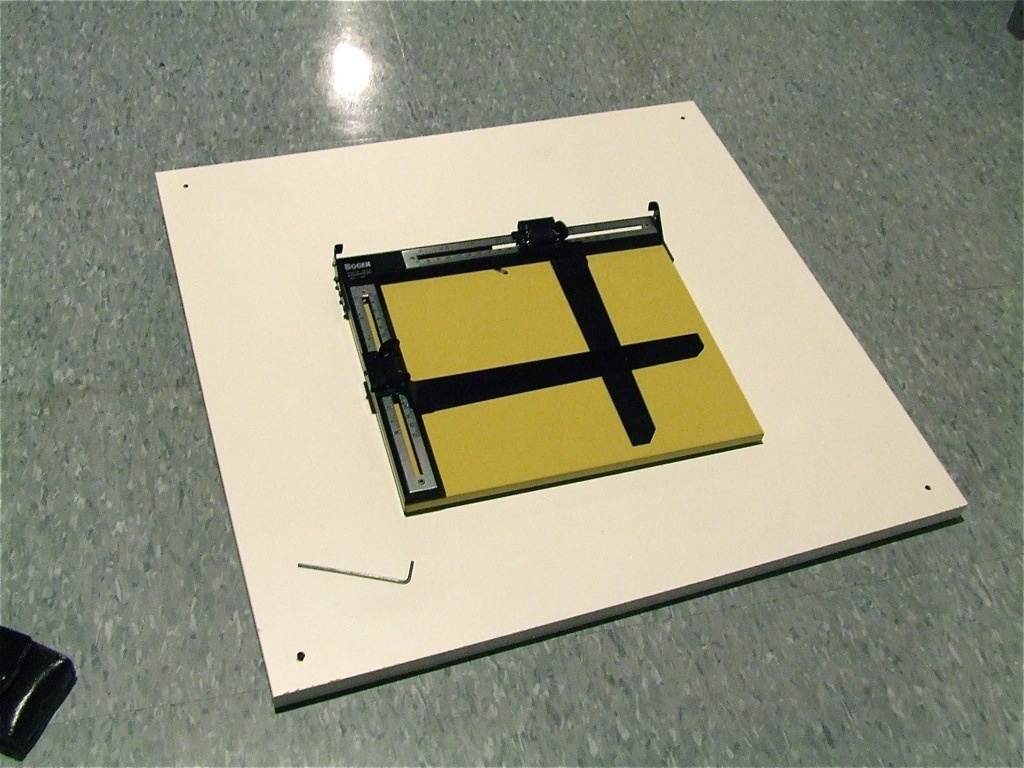

This is an adjustable enlarger baseboard for enlargers with fixed (non adjustable column). It sits on the enlarger baseboard and allows you to align the easel to the lens and negative. Realize that lens-to-negative alignment is much more important, so do that first and use this if you are still having problems.

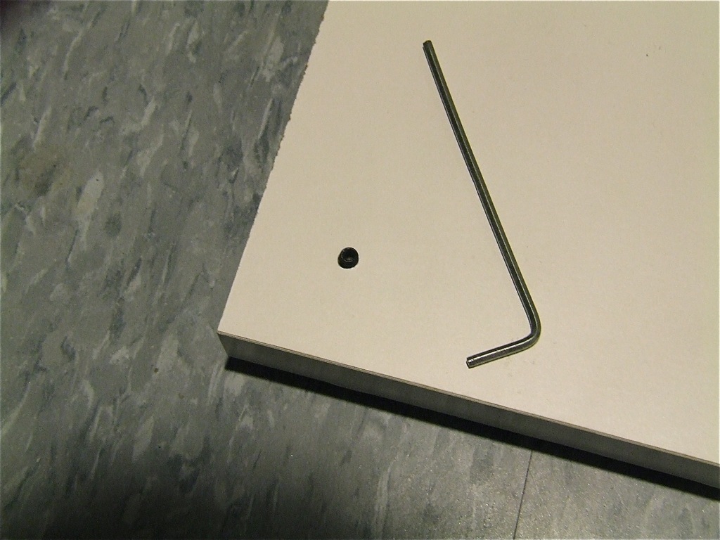

From the top the height of the 4 corner grub screws can be adjusted with an Allen wrench to achieve alignment:

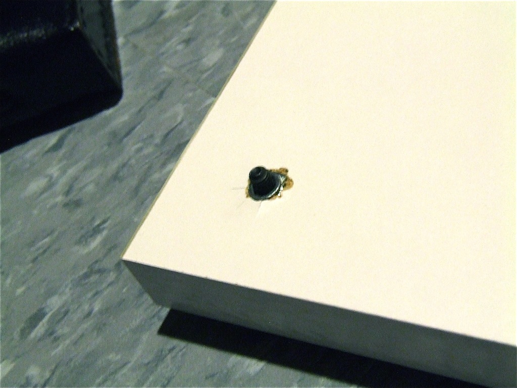

View from the bottom showing the protruding end of the grub screw that will contact the enlarger baseboard:

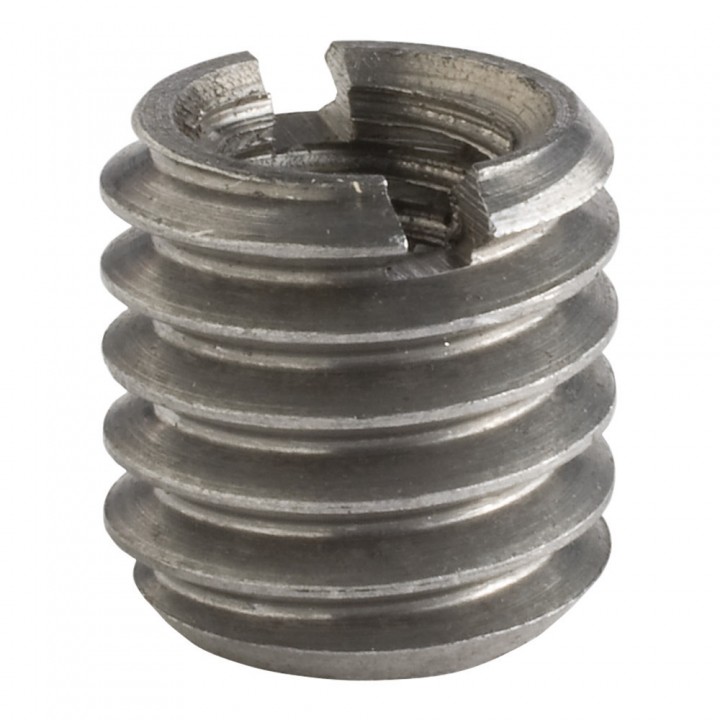

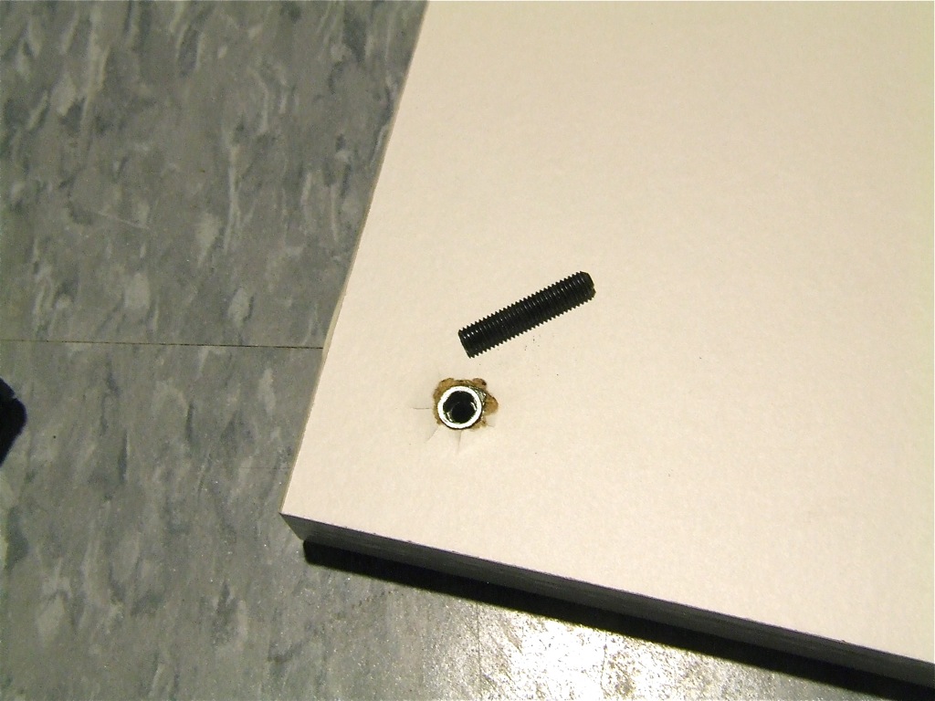

The grub screw is inserted in a 'threaded insert' that is threaded into the wood after first drilling the appropriate-sized hole:
