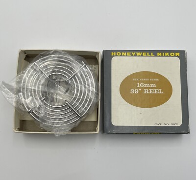

I have a 16mm/110 stainless reel that I bought for $5 or $10 within the last couple years. Can't remember where I got it for sure, but I think probably a local used camera store.
I also have a Yankee Master tank that has a reel usable for 110. I prefer the stainless reel (just as I do for 35mm and 120).
Ha, I refused to buy one of these for $5 to keep from being tempted. I always wanted to buy a Minox carrier for my 4x5 Beseler, absurdity 😊

I have used both metal spiral and Jobo 16mm/110 reels since 1985 and have obtained excellent results with both.
The metal ones don't work in the Jobo processor, but the Jobo reels will fit in a metal tank.
So, depending on the type of tank you have, you will need the appropriate reels.
