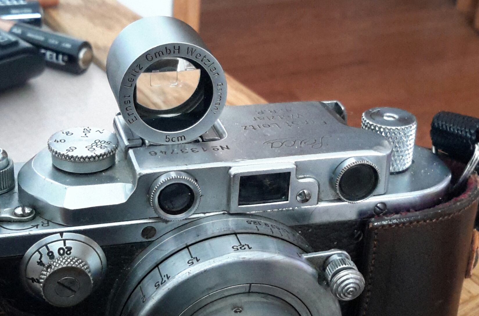

Here's my 1934 Leica III. 1934 if I have a correct S/N chart.
