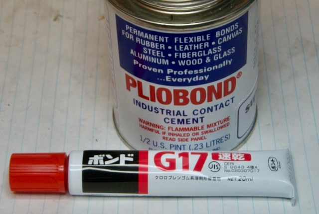

Polarbearcamera.com, UK based, sell some useful camera repair items. They offer a glue - Konishibond G17 which appears to have similar properties to Pliobond. Worth checking with them.
You need EvoStik 'Time Bond', useful for around the house and not just cameras. Spread it onto both surfaces and wait a few minutes before pressing them together, it will allow some repositioning time. Any excess that squidges out around the edges don't clean it up with solvent etc., make a dry ball of the glue and using tweezers to hold it use this to pull off any excess glue around the edges on the 'glue sticking to glue principle'.
I tested Konishi G17 for Polarbear, they kindly sent me a tube, to compare with Pliobond 20.
It has similar properties ... though less solids, and much less odour.
It has a higher bond but material can still be removable.
Thank you that's really helpful.
I will give the Konishi Bond G17 a try. Pliobond just smells too strong.
