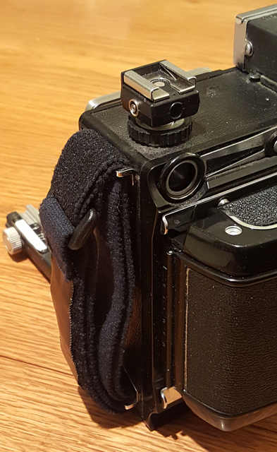

I was able to buy a Mamiya Press 65mm and finder relatively cheap, and adapt them to my Century. The reason I mention it is that the Mamiya 65mm finder is, of course, exactly right. To mount it, I got an accessory hot shoe/cord adapter with a 1/4-20 hole in the bottom, and bolted it to the top of my camera, on the left. This way, I also have a hot shoe for a flash, which is a nice addition.
The Mamiya 65 had some problems to get around regarding the sync plug, and its idosyncratic press focus mechanism, but I was able finally to integrate them into a new board. I also cobbled up a focus scale on masking tape, which I will eventually photograph, re-do in photoshop with real type, and print and laminate. No waste: I found someone who happened to need a Mamiya Press 65mm focus mount!
Mine didn't come with a strap, so I got a slightly stretchy and soft velcro strap about 18" long at the hardware store that fit with two or three passes through the strap loops. If I want a tight fit, I put my hand under all levels of the strap, against the body, but for a loose grip I can slip my hand in the middle of the stack somewhere, for a progressively looser grip. I think I like it better than the original handle, actually.
Another Century trick: cheaper and better-made than Graphic roll holders? Mamiya RB67 roll holders. You need to break a couple of tabs off the dark slide, then it's fine. Less than $40 each, all day long on Ebay.
The black skin is another mod. Mine was grey, but very ratty from a lot of use as a wedding camera. India ink fixed that. Someone on Ebay makes new graphite-laminate boards for about $20. Easier than making your own, and nicer, too.

After some conversation with Dan (Thanks!) I went ahead and removed the strap added a left hand grip to allow for a cable release and a flash.
There are some difficulties in fitting the Super Angulon lens to this camera and it needs to be done on a workbench with tools.
Even so I was not able to avoid a slip resulting in a fingerprint on the rear element.
The camera is now ready for use in the cold with gloves on, and I might take it over to Port Huron for a test.
Useful tricks, I have a RB67 ProS and I use the Graflex RH/10 backs on it but not the RB67 backs on the 2x3 as I thought they did not fit, not noticing that the cause is only the darkslide.
The leather strap on the 4x5 Speed here is frayed, so I will try your strap.

Update/ Adding some info about the Super Angulon 65mm mounting on the 2x3 Century:
The bed has to be horizontal ( ie the first click) because the front standard is straddling the hinge at infinity focus.
with the reference line for stops at about +10mm in front of the hinge.
If you need to drop the bed, pull the standard out until its leading edge is even with the rear of the outer bed rails. A 65 will then focus slightly through infinity and there's enough focusing travel to focus it to < 2 feet.
There is about 5mm of up shift limited by the rear cell pushing into the bellows folds.
There is only up( back) - tilt available, but the thumbscrews are behind the bed struts with difficult access.
As I keep saying, a Graphic is not a view camera.
With full downshift ( that is, standard, with the lens axis on the centre of the RH10) the bed is not obscuring the frame ( about 15mm leeway)
Have you tested with film? I just took a look through a 65/8 Fuji SW (flange-to-film distance within 0.5 mm of a 65/5.6 SA's) on a 2x3 Crown and you just might be right, even though I don't trust my lying eyes.
I am not able to screw in or unscrew by fingers, the cable to the Copal 0.0,
between the lensboard and the flare of the front cell, so I need needle nose pliers to do a lens change on the park bench.
You need one of these Dead Link Removed Leave it permanently attached to the shutter.
