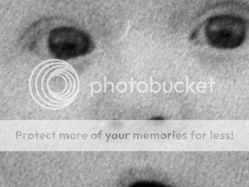

A 100% crop of the full sized scanned image (no PP at all) which would measure 195" x 132" (16' 3" x 11') at 72dpi or 47" x 32" (3' 11" x 2' 8")at 300 dpi.

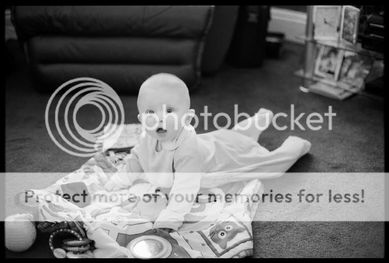

The full frame image has been resized (to 1200 pixel on the width) image of the whole frame including the borders. This has had some PP with some slight localised tonal changes in the brightest areas (using Nik Silver Efex Pro2) and some USM in CS5 and other than a few dust spots cloned and a slight vignetting at the corners there are no other changes.
