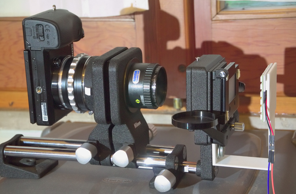

I use the following setup:
From back to front:
Sony A6000
Sony->Nikon adapter
Nikon PB-5 bellow
Nikon->M39 adapter
Rodenstock Apo-Rodagon N 50/2.8
Nikon PS-4 film duplicating holder
Custom bracket
LED panel
Actually, I have now swapped the Rodagon-N for a Rodagon-D2X (better border sharpness).

Nice set-up. This is similar to what I was working on with the Pentax Bellows II (plus slide copier). Do you shield the gap between the lens and slide? The Pentax slide copier has a secondary bellows to cut out extraneous light, and without it (or some type of shielding), glare destroys contrast. With the Durst unit it is not an issue because the light source in the base is much brighter than room lighting .
That's a good point. I originally made a skirt for my setup, which isn't as elaborate being a lightboard set below a tripod, but later found out it was easier to just mask off the light around the negative (I use a traditional enlarger negative carrier for this) and turning off the room lights before exposing.
Yes, the slide holder has its own retractable mini-bellows. I retracted it for the picture (to show the lens).
