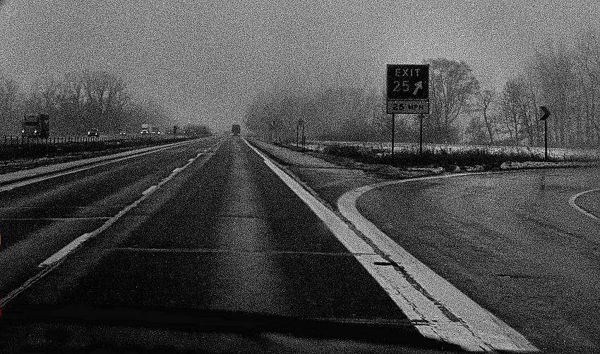

How do you analysis that gallery image ?
I have impressed with that image very much. Owner says it was Olympus XA and set to 400 asa and early dark morning , ordered lab d76 1:1 one stop push development.
I am putting a copy here:
Photographer is Mlehrman.

I wouldn't worry about it too much. People draw way too many conclusions about films and developers based on posted scans of negatives etc. You can't really tell anything that way.
True, that image looks like another I posted with a woman in it, but to avoid issues and out of respect for Mustafa's perspective and beliefs I won't post it here.
But D3200 film will do just fine, or pushing Tri-x to 1600 in Rodinal (which I've done) will work.
