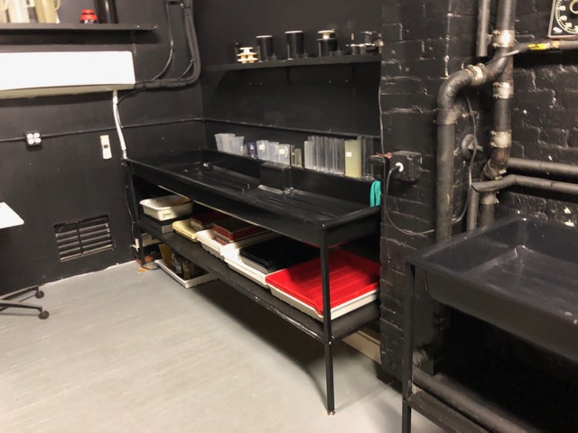

Does anyone have their Delta 8-foot sink right at hand? See picture for the type I am talking about. I am wondering about the actual interior length where the ‘floor’ of the basin meets the end walls.
Thanks in advance,
Jon
This looks exactly like one I have. Mine is 22” x 89” from the absolute bottom of the slant where the side walls meet the bottom. An inch or two higher and you gain 2 inches plus. Also, the space right in the center is narrower where there is the platform for a faucet. (I’ve never seen one mounted there.). It.s 19.5”.
